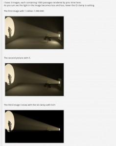

In this comparison its pretty clear that octane too (like fstorm, corona, vray) clamps just secondary ray intensity. This keeps sharp highlights in glossy reflections and direct lighting mostly intact and providing nicer clean render not just removing fireflies.
