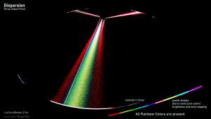

Re: spectral rendering
Posted: Tue Oct 20, 2020 7:17 pm
by FarbigeWelt
- Three Sided Prism
