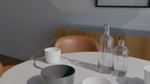

I was wondering if you can help me.
I have an animation with a static hdri but some objects are flickering. https://streamable.com/tjylqi
I rendered with pathtracing, gpu and "add light tracing". The caches were photongi with indirect and environment Cache. My guess is, that every objects with a glossiness beneath the glosiness threshole of the "add light tracing" setting are flickering.
What are the best settings for a animated camera in a static interior?
Thank you

I'm working with the daily build 2.4 of luxcore from yesterday and blender 2.83.11.
So I think the mentioned bug (https://github.com/LuxCoreRender/LuxCore/issues/312) is fixed, right?
I'm rendering the different caches, caustics and persistent caches versions.
But meanwhile I would like to know, if the glowing phenomenon in this video has something to do with the flickering caustics.
https://streamable.com/u94gex What you see is the setup with the hdri and when I switch to viewport rendering and turn down the exposure of the hdri, everything becomes darker but the glossy materials not. The ceramics are glowing. If I change the view in the viewport this effect is gone, but can be started again, if you reset the exposure, switch to solid view, start viewport rendering and lower the exporsure again. If I turn of the causticts, this effect doesn't happen. Is this a normal behaviour?

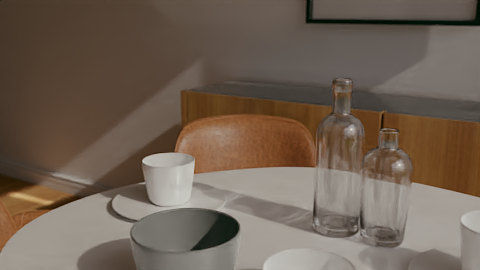

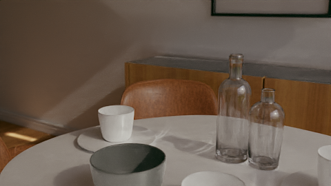

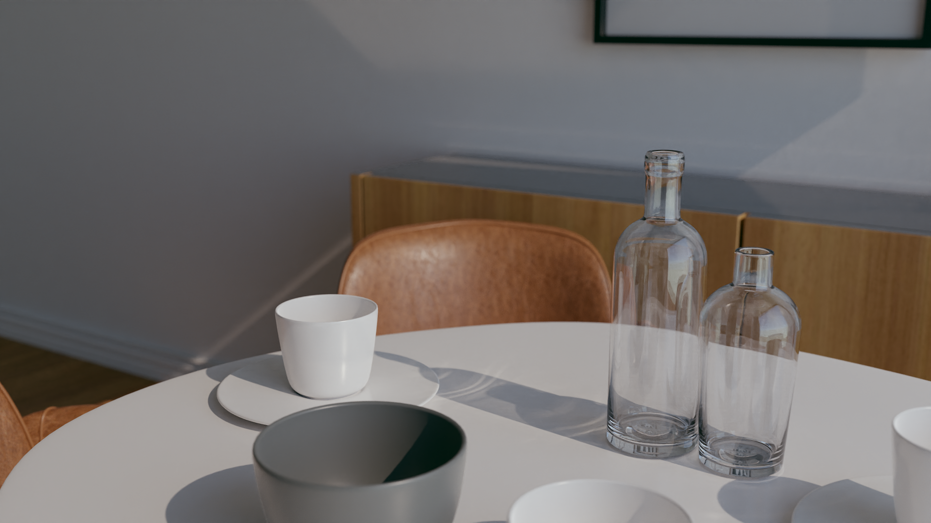

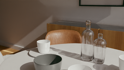

Hi B.Y.O.B. is a bug with luxcore version 2.4. If I take this file https://we.tl/t-GXdeoNOB20, and render an animation with an hdri, the first and the second frame differs in lighting. This doesn't happen if I use sun and sky, this is why I thought I did a mistake. The third frame looks like the second one regarding lighting. I used persistent photon and env cache. In comparision to V2.3, the first frame looks too bright, the second one too dark.
LUX 2.4 HDRI
LUX 2.3 HDRI
LUX 2.4 Sun and Sky
