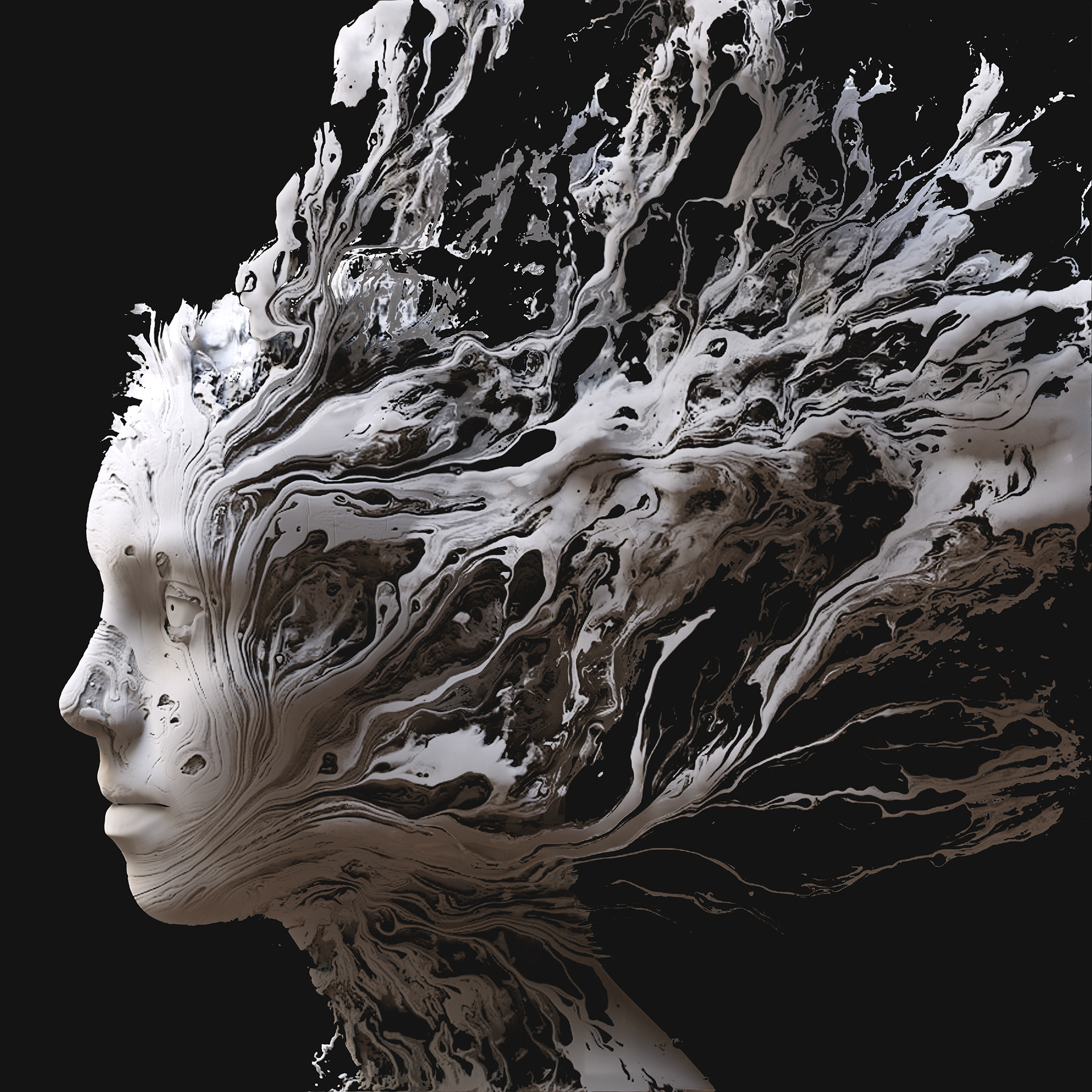

Q: Is or will Volume Displacement be possible?
For example -
Lee Griggs's Volume Mesh
Re: (Open)Subdiv and Displacement shapes
Posted: Fri Oct 18, 2019 3:45 pm
by Dade
It looks more like something for an OpenVDB file to me:
viewtopic.php?f=5&t=212 (yes, it you follow the link it has been done with volumes in Arnold too).
