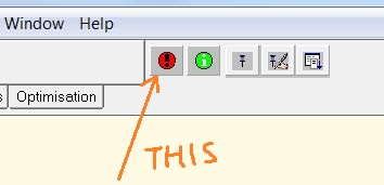

is there way to stop winlens flashing
this?

I'm not a WinLens user myself (once had a look at it before), so I just installed it again to check.
It seems it just complains about old glass types that are not manufactured anymore.
If you just want to replicate a lens in LuxCore for rendering you can safely ignore it. It would only be a problem if you want to actually manufacture the lens system in real life

I figured that much. I just can't do anything with that crap blinking.

wasd wrote: ↑Fri Mar 27, 2020 8:01 pm
Hmm, what exactly odoesn't work? I seem to be able to use all features of WInLens Basic even with the warning.

by wasd
The problem is blinking. It's distracting, the only thing I can think is the person who invented that blinker and things I want to do to that "software designer".

by wasd
Managed to replace glass via Database/Glass Database map, but that software design from early 90s is something.
