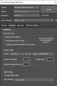

By the way, as we are in quarantine at this moment and I have more time to spend on the LuxCoreRenderer project, I finished the selection device for render part and now it's possible to select between hardware devices for render and use just selected device.
At the moment it works for up to 3 devices, just to be sure it's working properly and maybe use a list box in the future to show as many devices as available for render.

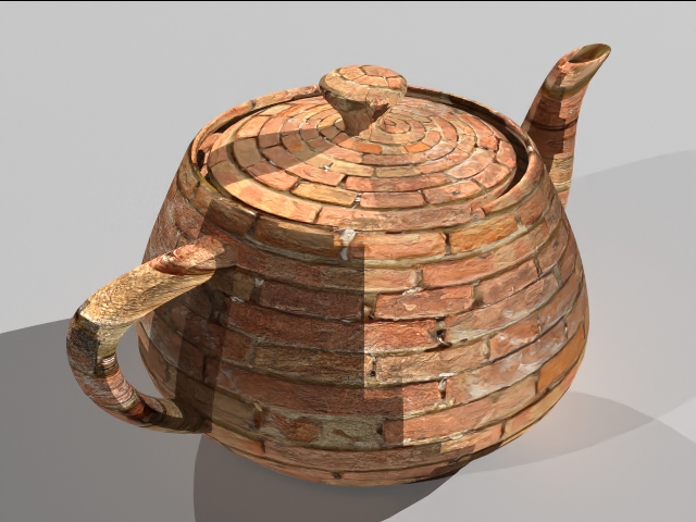

I face old issues that really need to be fixed.

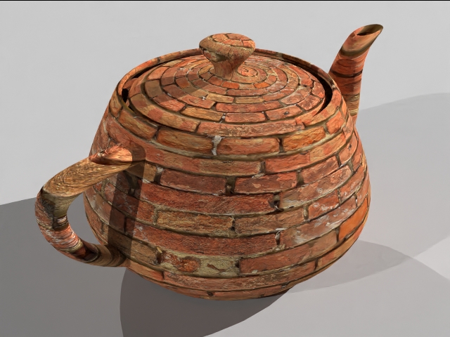

When I render the scene without any bump everything looks fine but as soon as I add any bump texture odd shadow on objects begin to appear and it looks like about shadows stopper or segment issue or some other problems.
Here some images to look at and of course dumb scene.
Dave a little help here, please.
Re: MaxToLux - 3ds Max Integration for LuxCore
It looks to me like the bump is just way too strong.
Use a scale texture between the imagemap und the .bumptex slot to multiply the imagemap with something like 0.001.

Thank you B.Y.O.B
That solves the issue, I can still see a little bit black when I try to apply bump but it's acceptable.

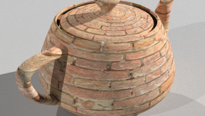

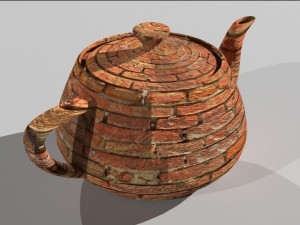

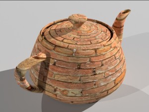

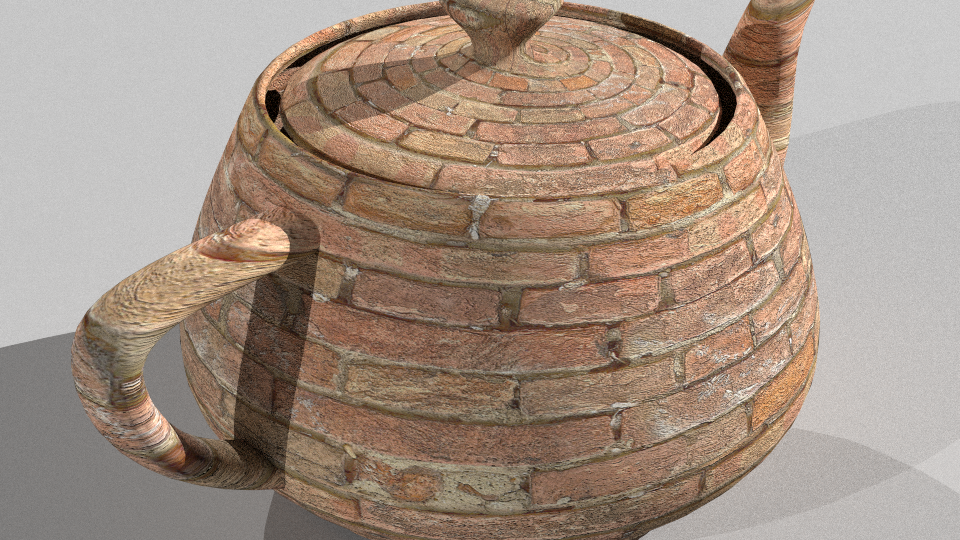

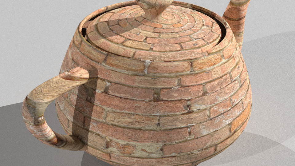

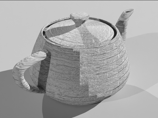

About the odd shadow on objects, I tried to use scale texture in between bump and normal map it somehow works and didn't dork at the same time.
When scale parameter is too low it seems work but with really small value. I barely can see the effect.
Especially about Normal Map. Maybe there is an issue with Normal direction.
Scale 0.01
Scale 0.05
Scale 0.05 without Diffuse map
Same Normal Map Different light setup (Sun & Sky)

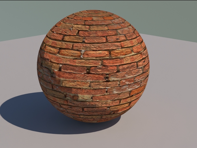

Other software Without Normal map
Same Normal Map other software

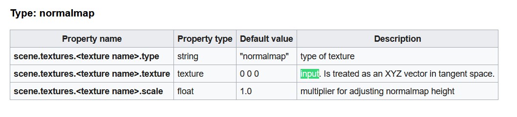

Are you using the "normalmap" texture in LuxCore? It has a "scale" property.
https://wiki.luxcorerender.org/LuxCore_ ... _normalmap

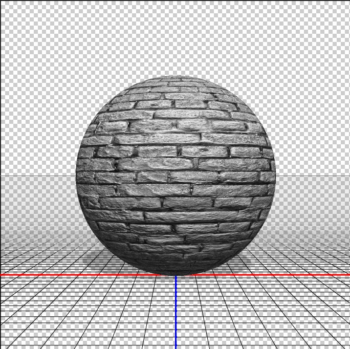

Maybe the problem is about input value in the Normal map.
What exactly the input value is?
Is that another image map or texture or something else?
I tried to input another image/texture but I get the same result.
