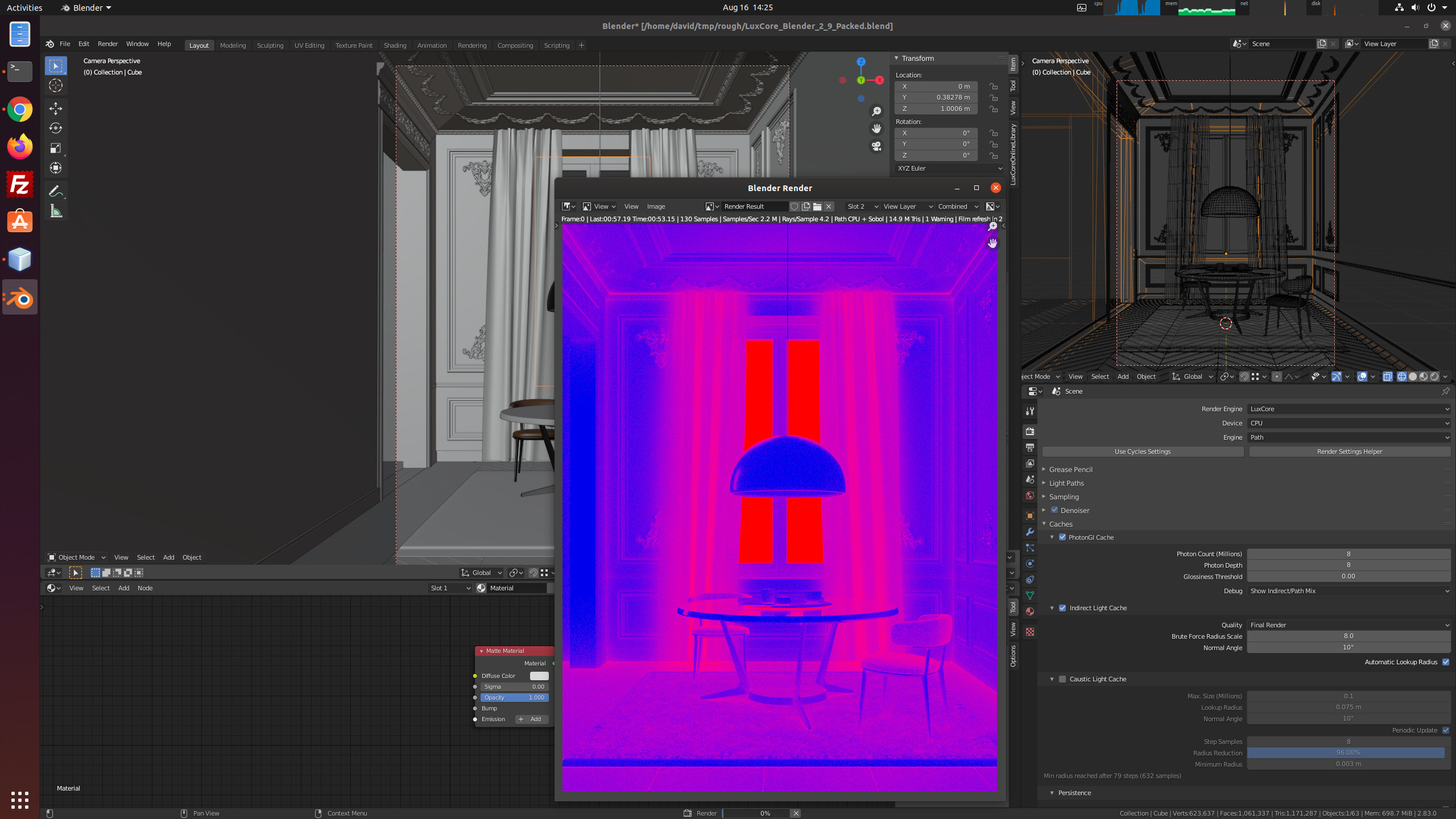

About your image...well.... I'd like to have something like you've got.
I've opened the scene I've sent you.
To avoid possible problems with the 2.9, I've opened the scene with 2.83.4 and, as the previous tests, I'm using latest BlendLuxCore 2.5 alpha.
I've changed "normal angle" to default 10° and set brute force radius scale to 0 and this is what I've got.

marcatore wrote: Sun Aug 16, 2020 11:44 am
This is with 8 inside blender with your parameters:
and this with 0:
The difference is there and is large.
There is a difference with the results I posted because they were rendered outside Blender
without the color curve re-map/post-processing your scene seems to have.
This is a normal rendering outside Vs inside Blender:
As you see, you are doing some kind of heavy tone mapping/color curve re-mpapping/post-processing. Indeed, you should render the debug images without any post-processing or your perception may be heavily screwed.
Re: PhotonGI cache
Posted: Sun Aug 16, 2020 3:22 pm
by marcatore
you're right. It's the color management.
I'll try to come back to a normal setup but I'm finding problem with camera tonemapping. I've tried to use the rehinard but it's not so intuitive.
The balance overburned area/general lighting is difficult to find with the camera tonemapping settings.
BYOB, Is it possible to avoid this behaviour inside Blender? As it's a debug tool, it shouldn't be modified by the Blender color management.

by B.Y.O.B.
marcatore wrote: Sun Aug 16, 2020 3:22 pm
I already have measures in place to counter Blender's exposure:
https://github.com/LuxCoreRender/BlendL ... ine.py#L18
And the tonemapper is set to linear.
What else is happening in your case? It would be good to get a stripped-down version of the scene that shows the color management and imagepipeline settings.
