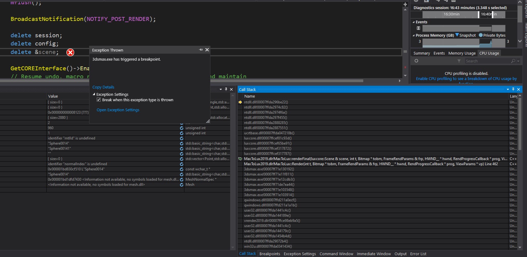

Re: crashes - A heap has been corrupted error
Dade wrote: Tue Nov 30, 2021 10:07 pm
TAO wrote: Tue Nov 30, 2021 9:36 pm I will dig a little bit more maybe I made a mistake in other arguments.
Try to post a debugger stack backtrace of the crash (i.e. where in the Scene destructor is the crash).
Call stack
error list and other parts showing nothing.
just a critical error number in the output.

Critical error detected c0000374
3dsmax.exe has triggered a breakpoint.
Note, if I had more objects with multi-materials in the scene it is more likely to reach the error. the render itself continues and the problem is when canceling the render.

Found the issue, it was a wrong number of UV parameters, in 3dsmax UV is a Point3 variable and has 3 values for u,v, and w, as I rewrite all mesh functions I did not notice the difference between the 3dsmax Point3 variable and LuxcoreRender Point2 UV parameters, because of that I had 1/3 more value than UV input should have, so base on an object and UV setup I may or may not face the issue.
The problem is solved now.
