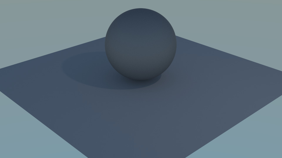

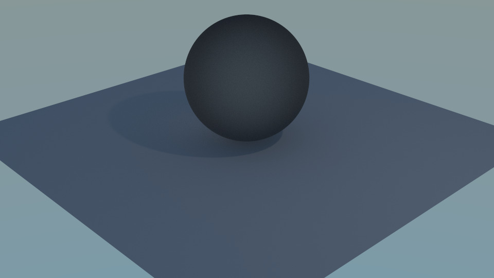

I fixed a bug in rough glass material. This was before the fix:
and this is now:

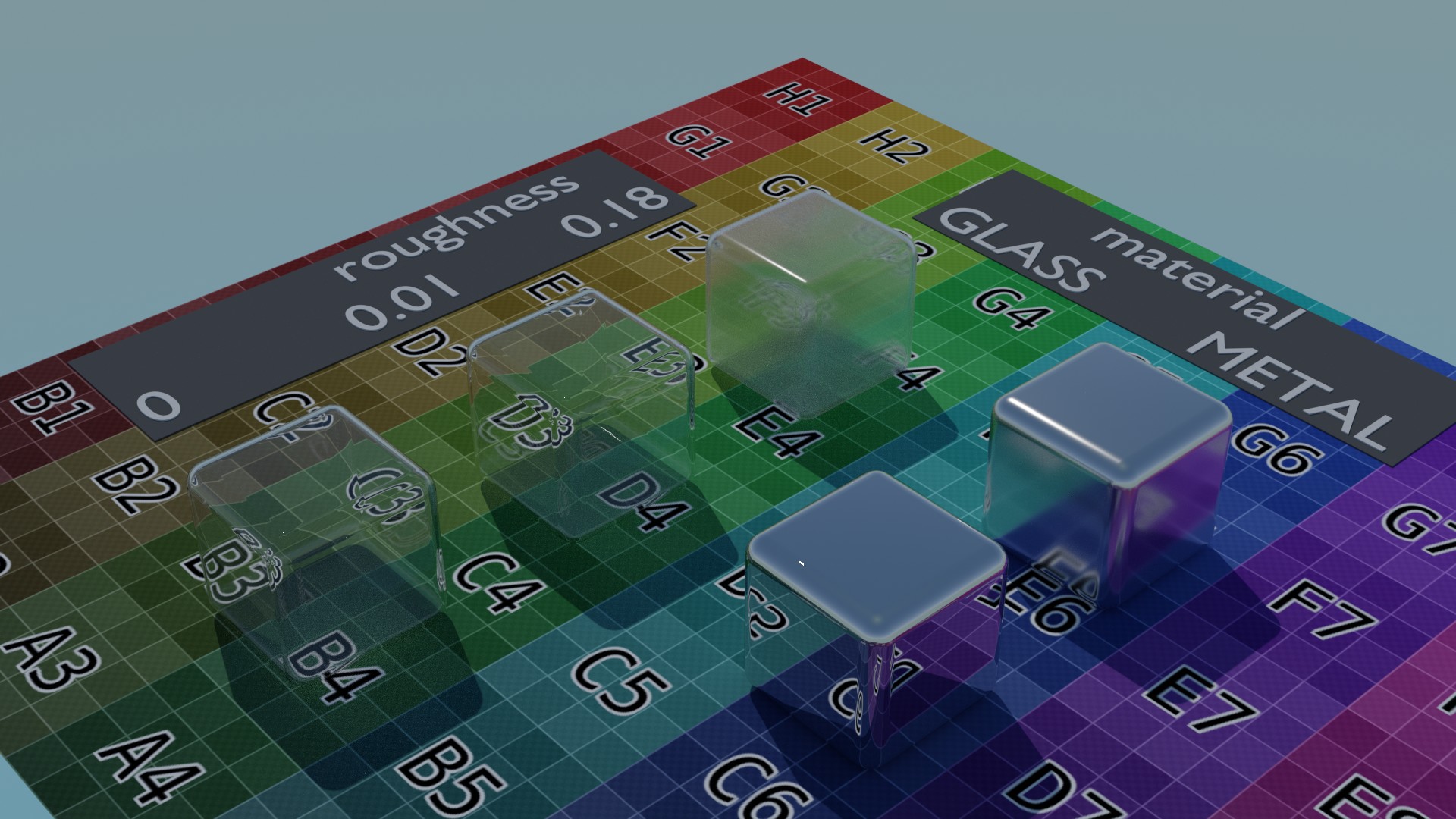

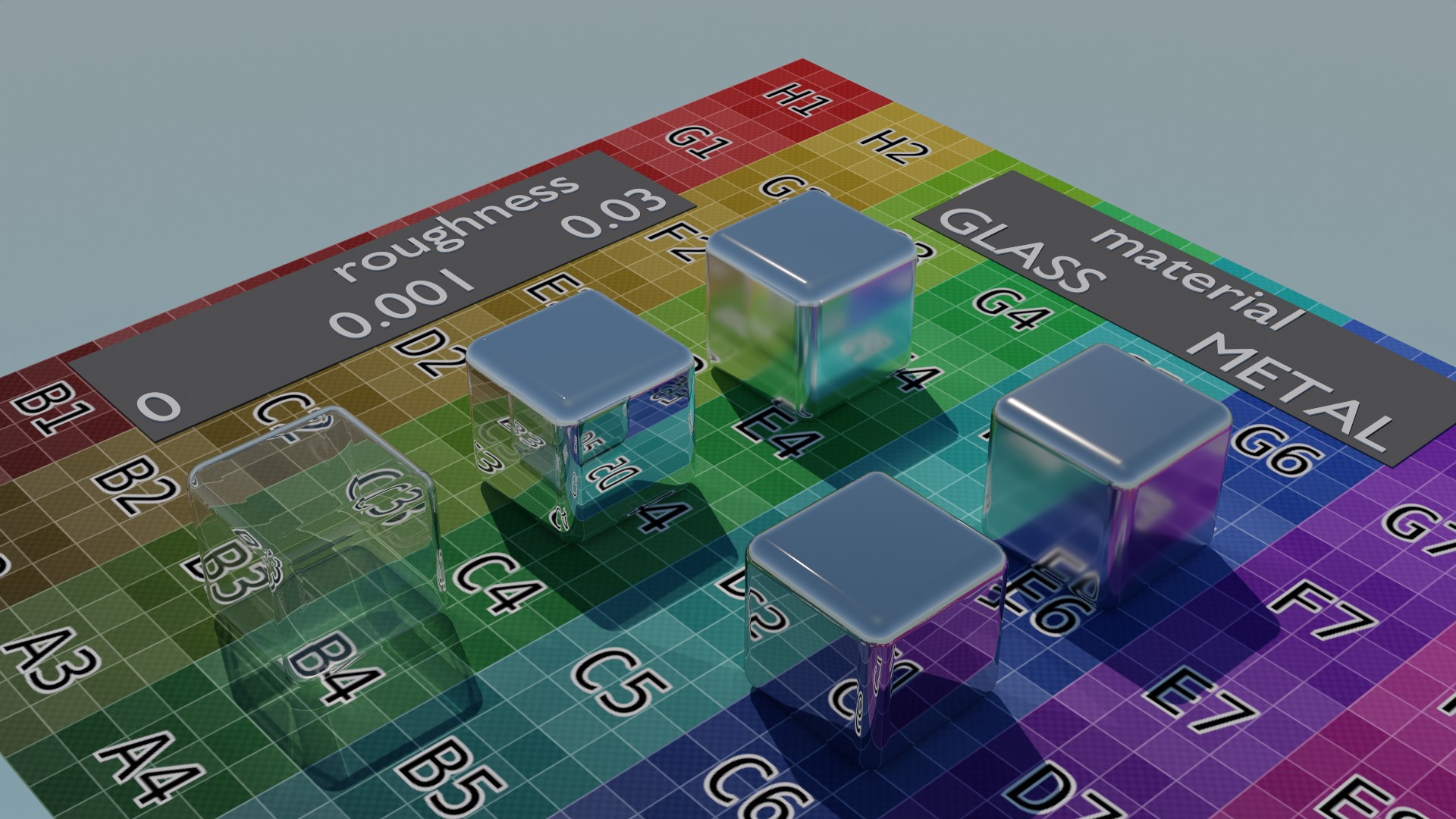

Hi Dade, I have built that commit but it seems still not correct. :?
From what I can guess/observe by looking at the render result, it looks like the transmission is not present in the rough glass, and perhaps the normals are a bit weird also.
In this rendering I have placed some metal materials next to the rough glass for comparison. The object is just a cube with a bevel and solidify modifier, to give the surface a real thickness, in this way you can see the transmission effects of the glass more easily. And the UV grid on the ground plane allows you to see what is reflected vs. what is transmitted.
roughglass.blend
(348.61 KiB) Downloaded 894 times
Edit: and here is the equivalent in Cycles. Also interesting to note is the different roughness values to achieve the same look.

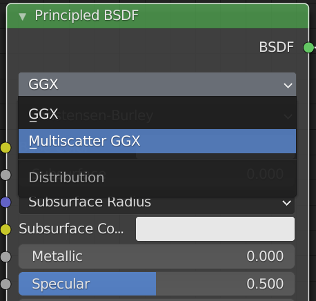

Ah, that must explain why they have this: :idea:
Cycles Principled Shader Distribution setting
And I guess that means we would have to do something similar (at least for the Disney material). Maybe for roughglass it's OK for LuxCore to use Multiscatter GGX exclusively?
