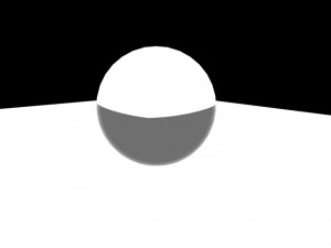

Post by Dez! »
https://i.imgur.com/lE6Kd2p.png
Probably it is wrong

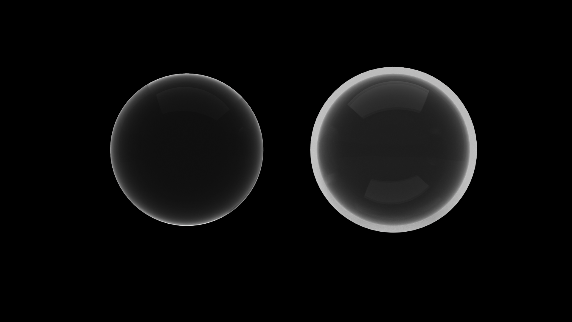

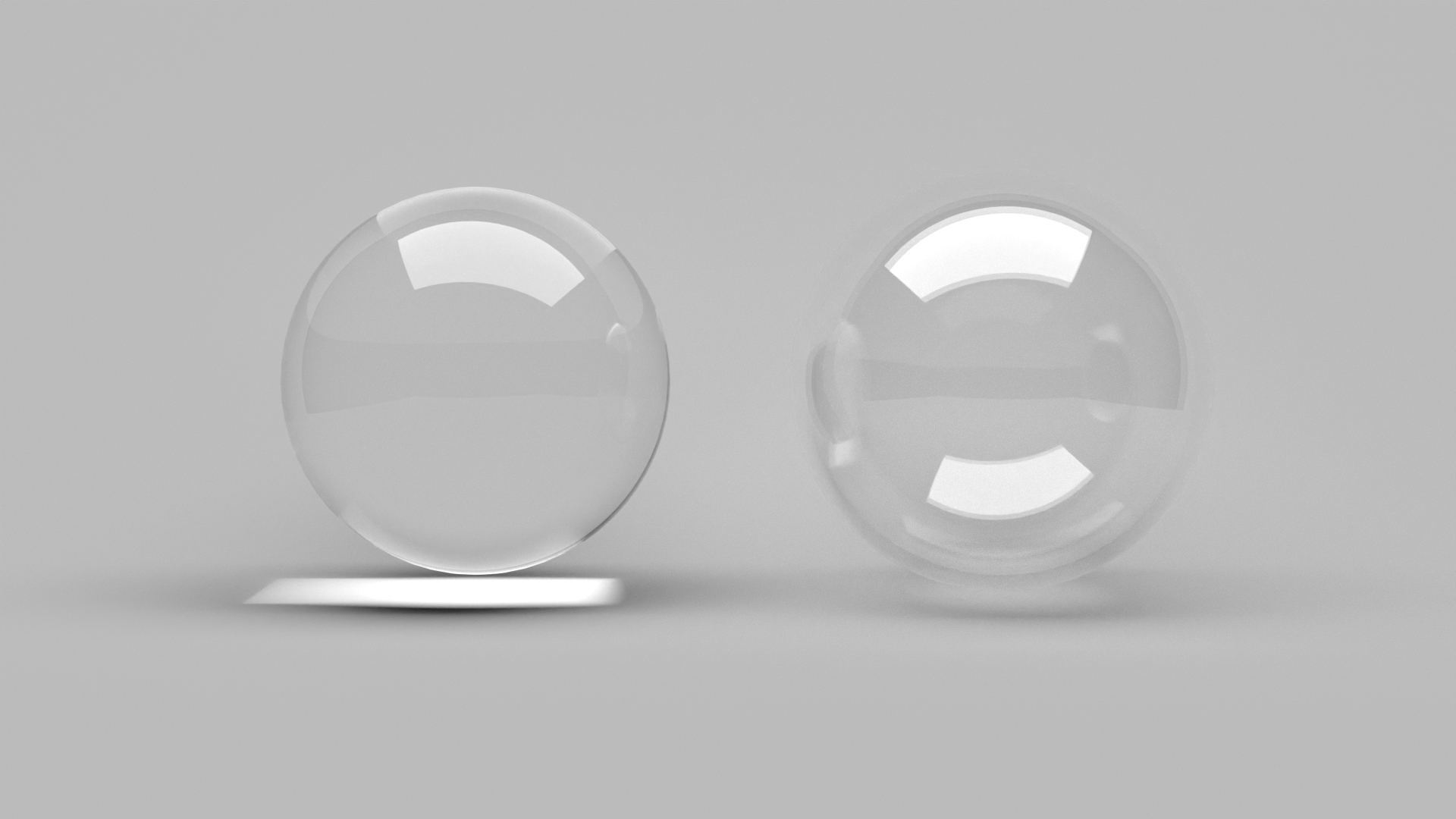

Yes sure. Here it is.
Re: Would it be possible to get Alpha on Glass Materials?
JulianoLisboa wrote: Mon May 10, 2021 12:34 pm Yes sure. Here it is.sphere_beauty.jpgsphere_beauty.png
What is the difference between the 2 spheres ? Is it the amount of reflection ?
It seems to set alpha=0 if the ray is transmitted or alpha 1.0 if it is reflected :idea:

The one on the left is solid and the one on the right is thick (solidify)

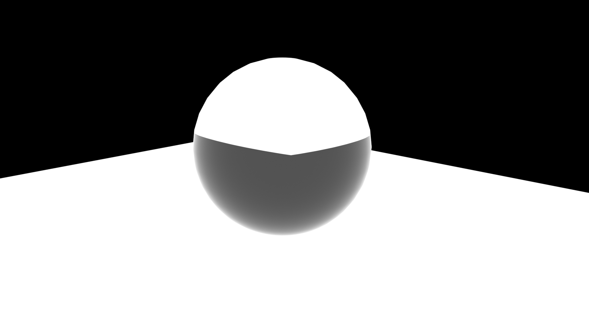

This doesn't make sense, you have a solid background in your rendering and the alpha channel of that rendering is, by definition, all white (with or without the 2 glass spheres, it doesn't matter). You are using something else, not the alpha channel. Please render a glass sphere over a plane like this (RGB and Alpha):
We can argue about the alpha channel of pixels belonging to the sphere but the alpha of plane pixels must be 1. Otherwise you are using some kind of shadow catcher or similar.

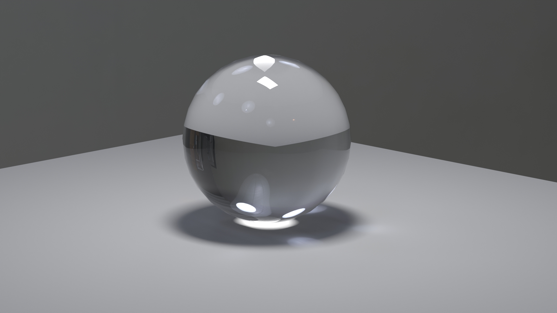

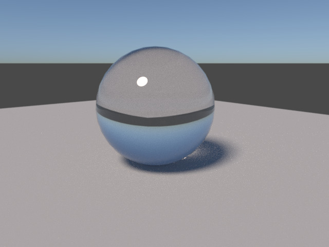

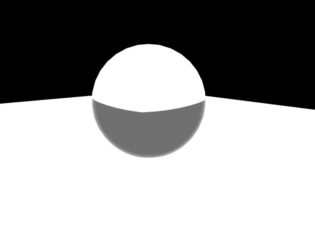

I reworked how alpha channel is handled for purely transmitted eye paths and the result should match what was asked:
This change is available in v2.6 daily builds.
The last question is if this new behavior should be used far all kind of transmitted paths (like in the new code) or only for specular one (i.e. glass but not rough glass, glossy translucent, etc.).

The reason I was not marking the glass as transparent is because you are not seeing directly what is beyond the glass but the ray is refracted and it lands in a different part of the sky.
So, if you use this new alpha channel for some kind of background compositing, you are not really ending with an accurate result. But I guess "something" is till better than "nothing"
