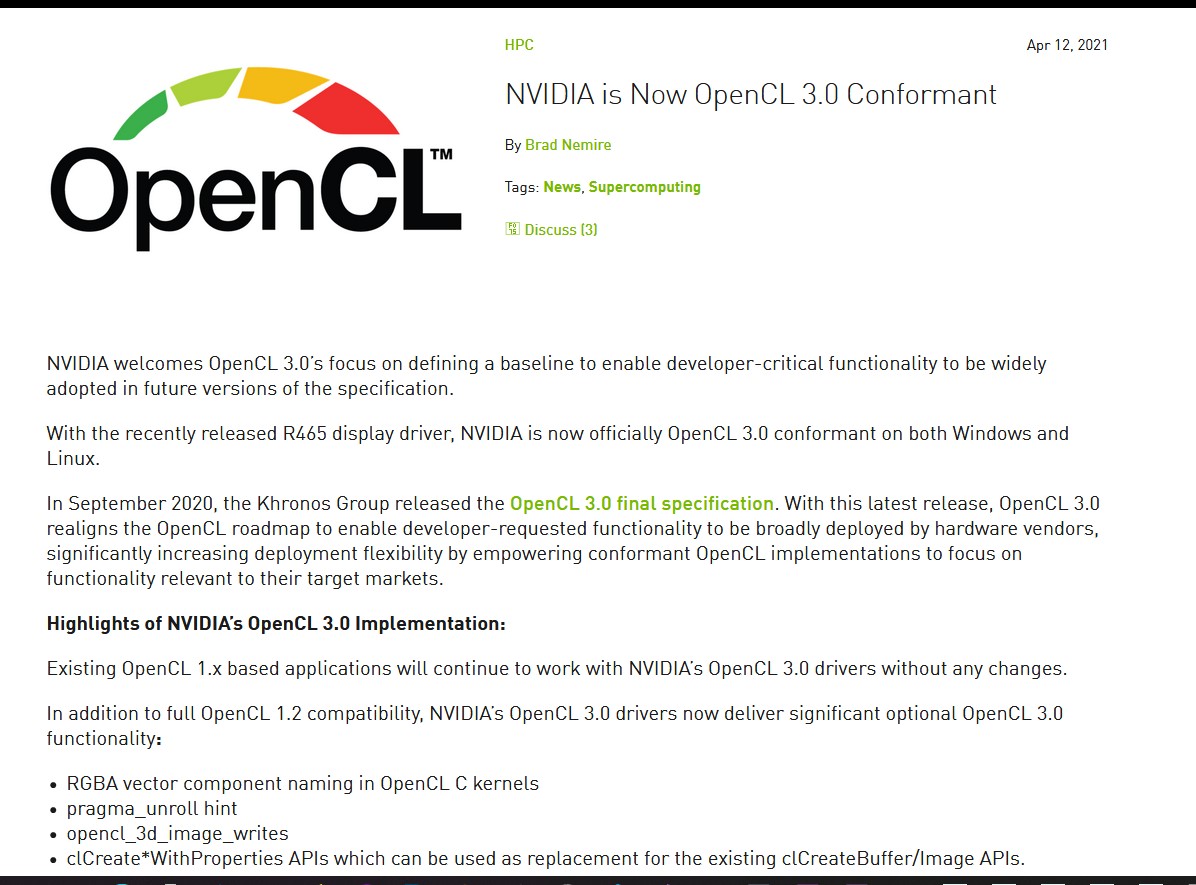

Re: Faster Compiling kernels
With the recently released R465 display driver, NVIDIA is now officially OpenCL 3.0 conformant on both Windows and Linux.

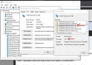

I already install and test it. it is really OpenCL 3.
I check every part of it, not just the file version and the result is the same.
