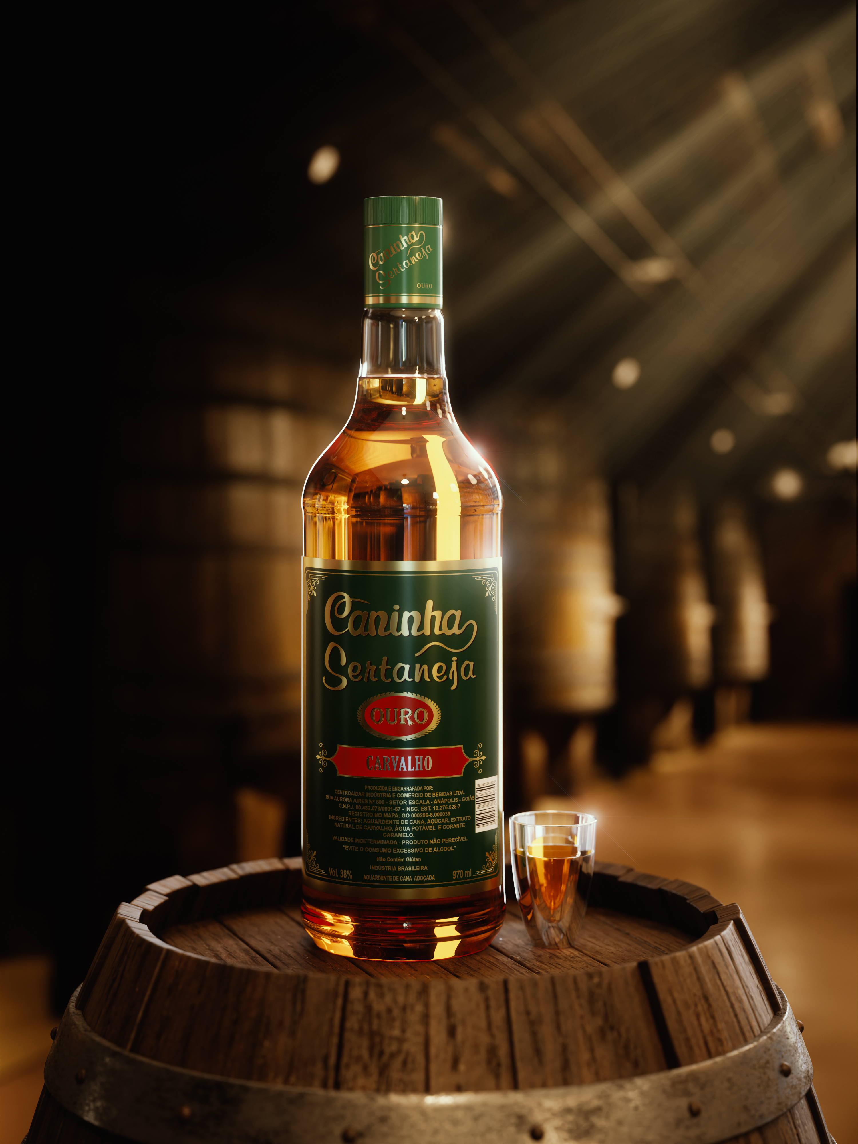

Can I see the shader node of both the glass cup and bottles ?
Can you also check normal orientation on the glass cup ?
Do you have shadow color applied at maximum white value on the glass cup ?

Much better, now it's great.

Thank you, but I am waiting for Sharlybg's comments, so I think it will get even better. He must have downloaded the file.
Re: Brazilian Liquor
Just have few minute to investigate the file a bit :JulianoLisboa wrote: Fri Apr 23, 2021 7:44 pm Thank you, but I am waiting for Sharlybg's comments, so I think it will get even better. He must have downloaded the file.
1__ You should work at real world scale with Luxcore to avoid starnge behaviour. Your bottle is 6Meter high here
2__ There is not to much challenging thing in the scene ( not like here : https://youtu.be/R2-u3YNJbHQ ) so Shadow color to white is a bit overkill almost switch off all nice caustic. So default for all is good here.
3__ The liquid mesh inside the bottle have normal inverted.
4__ You can imrove lighting by smoothing plane light edge like in this tutorial for a more natural blending look :
https://youtu.be/32Ojuidbc7k?t=155
Hope it help a bit.

Thanks to everyone who helped me, follow the final image.
Couldn'd imagine it will look like that at the end well done.
Much better than the initial version - especially the poured glass. One little thing. The label looks a bit dark now (especially the lower part). Maybe adding a little frontal/side light back in can fix that. Not as much as in the original version though.

Thank you friend, yes the observation proceeds, every time I look I think that the image is finished I find something to fix. About the label I wanted to look more dramatic, but it really got darker than necessary.AndreasResch wrote: Sat Apr 24, 2021 7:41 am Much better than the initial version - especially the poured glass. One little thing. The label looks a bit dark now (especially the lower part). Maybe adding a little frontal/side light back in can fix that. Not as much as in the original version though.
