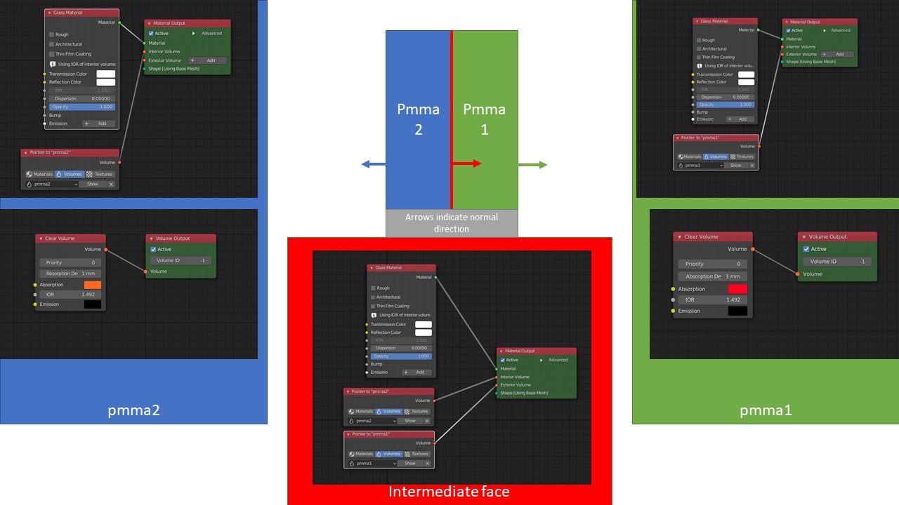

Jan wrote: Sat Apr 24, 2021 2:06 pm if you set distances to zero overlapping surfaces
There are no overlapping surfaces in that model.
One of the two faces that are shared by both volumes is deleted (or better said: has never been imported).
The remaining surface (marked in red) carries an interior and exterior volume as mentioned in this image:

Jan wrote: Sat Apr 24, 2021 2:06 pm Refraction and Reflection on the 2nd Glass Object below the First Glass Object no longer works if Faces are flipped
I think if you start flipping the face normals (see the arrows in the image) the algorythm will be confused with what is inside an outside of the volume.
