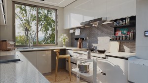

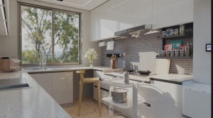

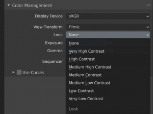

here are all the different looks that the filmic config offers
this is the direct output using filmic with no look
here is a demo of using filmic with "high contrast" look
As you can see, the "looks" really make filmic looks more pleasent depending on different result.
So, do we have "looks" implemented already? or will we?
