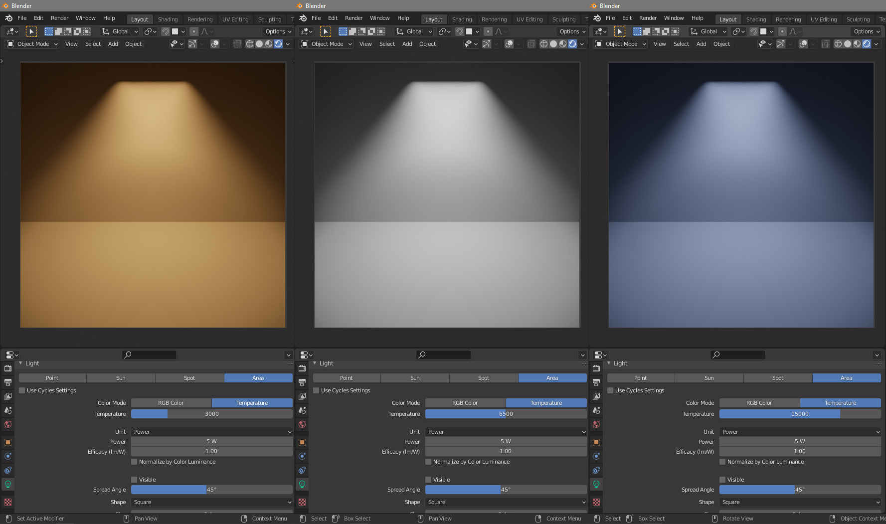

I added a section about the new model packs for the LuxCore Online Library.
About the temperature settings for light, Sharlybg, maybe you can render one of your lamps with three different light temperatures (orange, white, blue) to showcase this?

Luximage wrote: Wed Mar 24, 2021 2:22 pm
Lights temperature:
Added these.
