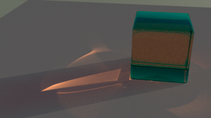

I still have the problem with the indirect specular pass, however. and the plot has thickened. Here are a few comparison images to better illustrate what's happening.
Combined render (standard view transform color management):
Combined render

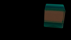

Indirect Specular pass (standard view transform color management):

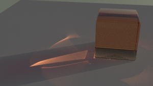

Assembled passes final result (standard view transform color management):

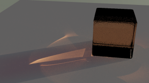

You can see how there's strange blueness showing up in the ind spec pass that shouldn't be there. I specified that it was using standard view transform color because if you have Filmic color on, your exported png of the third example image will look like this for some reason:
Assembled passes final result (Filmic)
Safe to say, I have no idea why any of this is going on, but I would love to know if it's something I'm doing wrong (and then how to do it right), or if it's really a bug. It's frustrating not being able to use all these passes as expected. Thanks!

steveernst117 wrote: Mon Feb 22, 2021 1:10 am Any news on this issue yet?
It is cause by NaNs. LuxCore film has a safety net to discard NaN samples for the main frame buffer but not for AOVs so you end with a valid complete render but with AOVs containing NaNs.
I'm extending the safety net to AOVs too.
Re: Indirect Specular pass problem
Posted: Mon Feb 22, 2021 11:57 am
by Dade
Actually, it was CPU-only problem because GPU code had already the complete safety net. It should be fixed in next automatic build.

What was causing the NaNs?
Posted: Tue Feb 23, 2021 9:56 am
by Dade
B.Y.O.B. wrote: Tue Feb 23, 2021 8:54 am What was causing the NaNs?
It was caused by the math of homogeneous volume transmittance over an infinite segment (and the infinite segment is caused by having the bottom of the cube and the ground plane overlapped).
