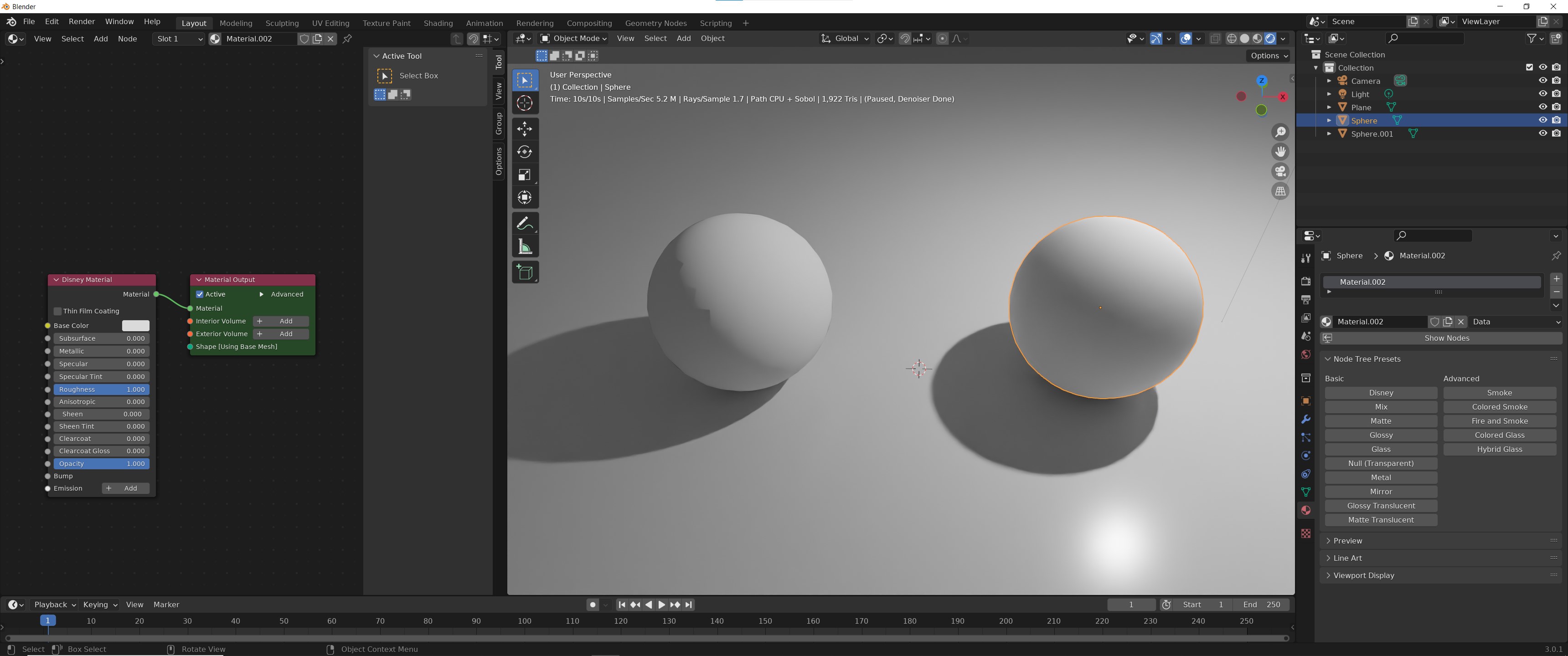

way late to this party but Disney has a different falloff behavior than Matte (and Glossy and Matte and Glossy Translucent) so maybe that's part of it?
Matte on the left Disney on the right.
