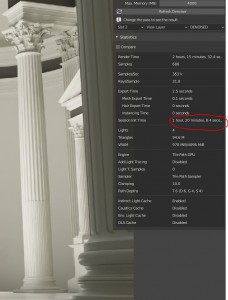

Re: Very long wait for caches enabled
Posted: Mon Nov 09, 2020 12:12 pm
by nigma46
although other camera angles are takin considerably longer, see attached.
1hr 20mins
1hr 20mins
Posted: Mon Nov 09, 2020 3:03 pm
by Dade
nigma46 wrote: Mon Nov 09, 2020 12:12 pm although other camera angles are takin considerably longer, see attached.
You have to consider how slow is your CPU: the pre-process of the same scene will take less than 5 minutes on an AMD 3900x.
Anyway, what do you mean with "camera angles" ? Other point of views ?
