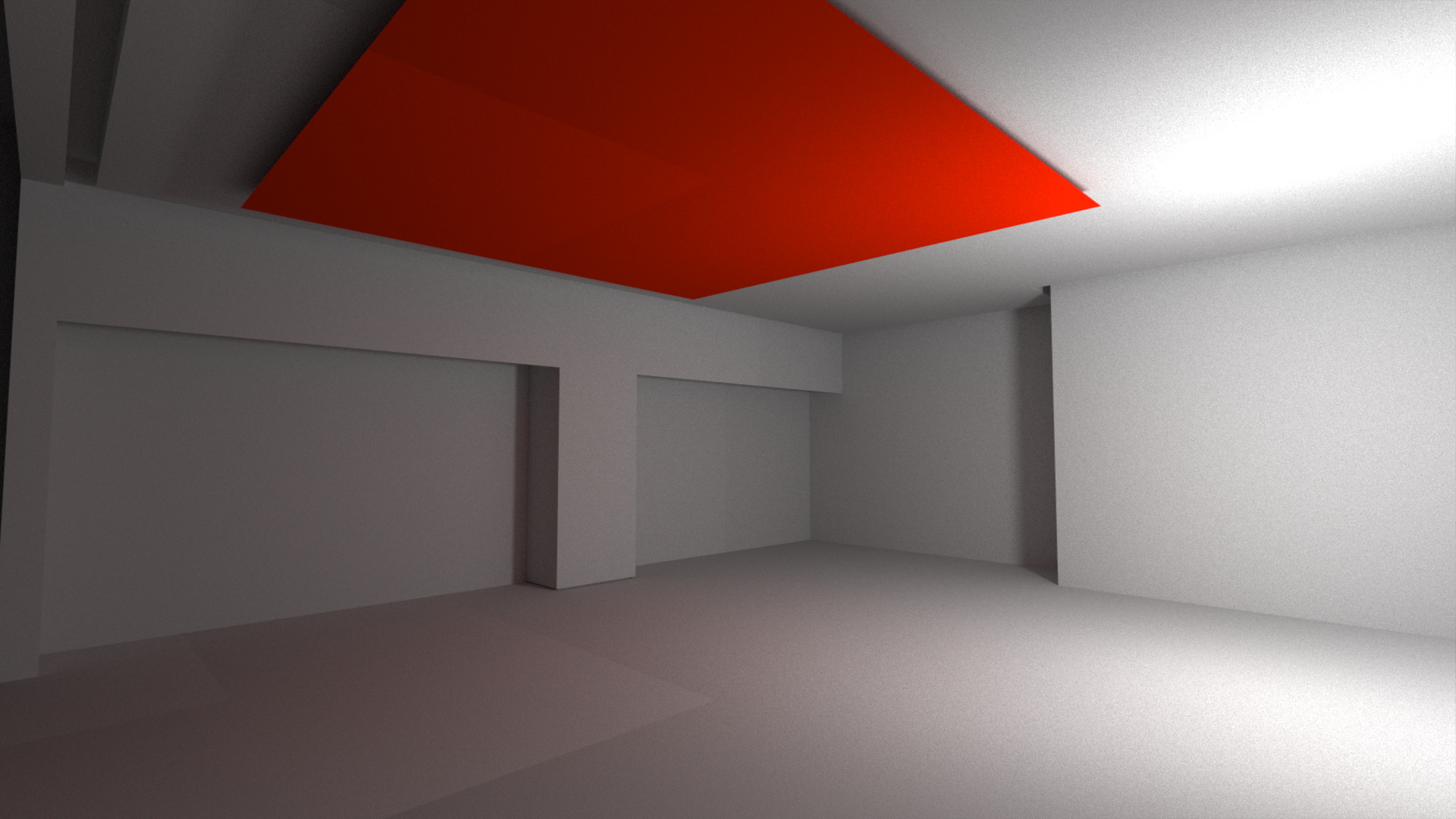

Dade wrote: Thu Oct 22, 2020 10:17 am
B.Y.O.B. wrote: Wed Oct 21, 2020 11:54 am Curious. That bright rectangle on the ceiling even shows up when rendered in Blender after importing the PLYs, with completely different lighting.
And it even shows on a fresh plane mesh that is slightly rotated, so it's probably not related to a problem in the ceiling mesh.
It is also BIDIRCPU only problem (inside eye pass) while the scene works fine with PATH(CPU or GPU).

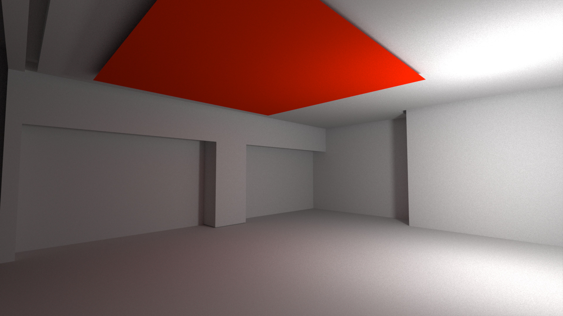

I should have fixed the problem. This was before:
and this after the fix:
Posts: 309
Re: question
Yessss! Grande!

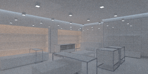

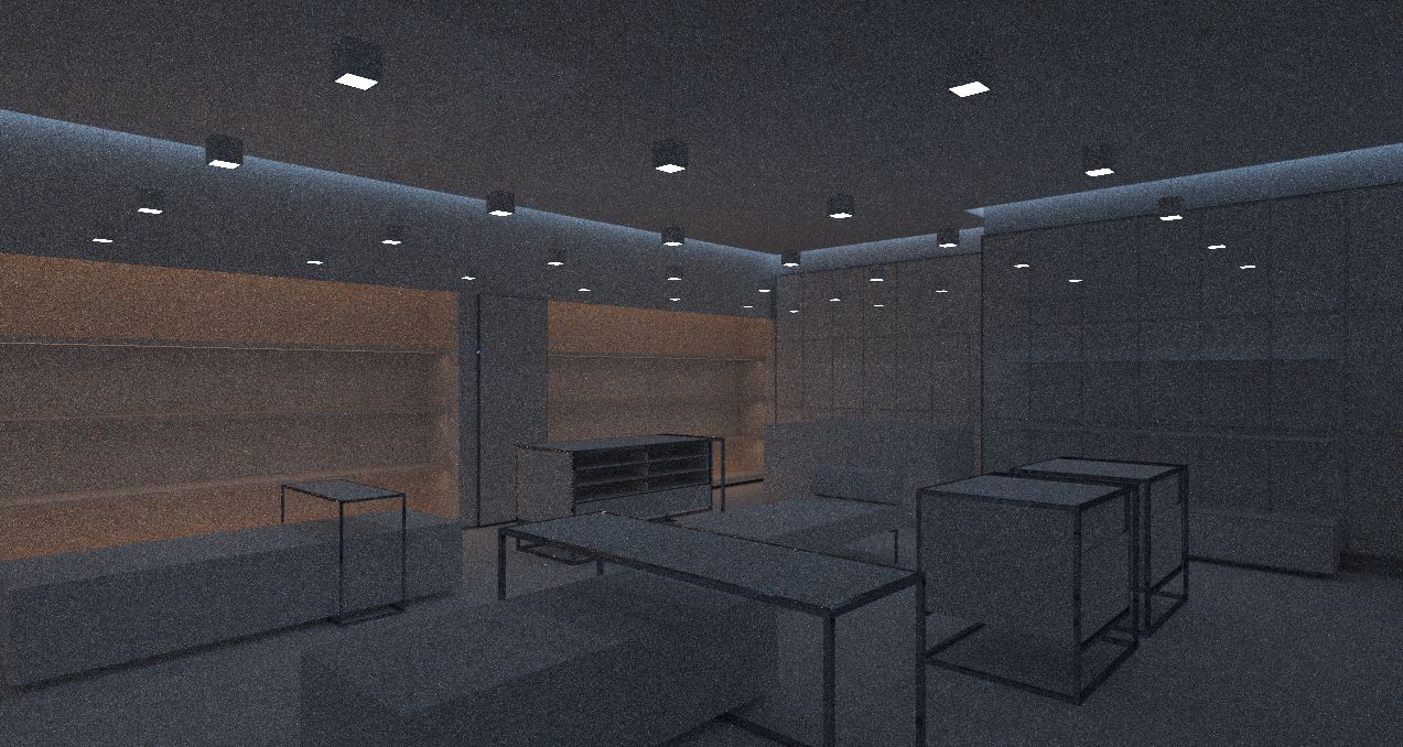

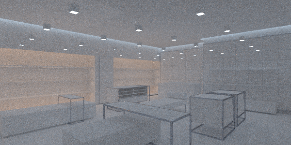

Sorry one more question. The attached scene, which was created using SDK, renders differently wen rendered on linux using SDK as rendered on windows using standalone 2.4. the brighter one is with SDK under linux and the darker one is using standalone under windows.

Re: question
daros wrote: Thu Oct 22, 2020 11:07 am And regarding the previously postes issue with 100% white materials? And which is eventually the maximum white point Luxcore handels?
I'm not sure to understand how the rendering was done. Have you set all materials to "Matte" with a value of "1.0 , 1.0, 1.0" ?
In that case, the result looks correct, light is perfectly reflected at any bounce: it is a very unrealistic scenario, light is always partially adsorbed on a bounce (White is usually something like "0.7, 0.7, 0.7").

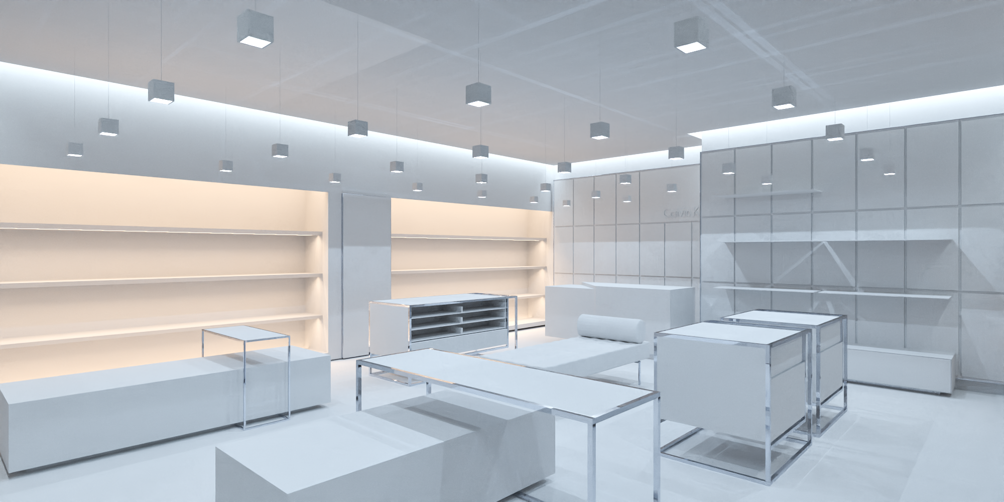

Thanks a lod Dade.
Light distribution ipmroved a lot!
This is a 70 seconds test using oidn.
