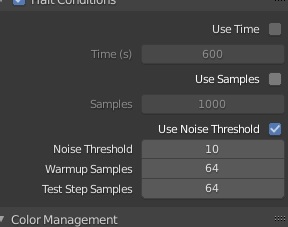

Sharlybg wrote: Wed Oct 07, 2020 10:26 am What is your clamping value ?
Hi Dravia! you mean this?
Its unchecked....
Re: Trying to get rid of fairflies, need advice.
Posted: Wed Oct 07, 2020 10:40 am
by zooropa
ok I needed to turn it off...its 55 minutes...and 1000px it does not make much sense...I hope I am doing wrong I really hope so hahah

Thank you ! I do know the video. It is hard to remember where and when to go to check it. Also the explanation about the feature is not really clear. I just repeated what you did and put the clamp value on 50. It could be nice to understand why and what I am doing that.

I am now using the clamp feature as suggested by the other user and wrote 50 in the value. Following the video he did he seems to use that value for the caustics. Do I still need to use the denoiser feature you suggested in 10 (the advance feature).

Using a value of 50 Max bright in clamp features...still gives me an endless render. Do you think it might be the settings in the denoiser ?
