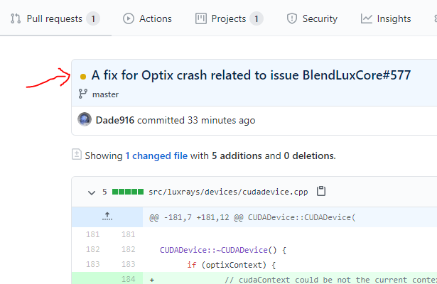

Re: Luxcore Optix crash investigation
Posted: Thu Nov 05, 2020 10:56 am
by B.Y.O.B.
Sharlybg wrote: Thu Nov 05, 2020 10:30 am Is lastest build have the fix for testing i mean ?
It will be available once the orange circle here turns into a green checkmark: https://github.com/LuxCoreRender/LuxCor ... 0ba6febf19
Note that the problem on the Blender addon side (session not being deleted when renderconfig is changed, leading to increasing RAM usage) is not affected by this change and still needs to be fixed. I'm currently looking into it.
Posted: Thu Nov 05, 2020 11:30 am
by Sharlybg
It is green Now :D
Posted: Thu Nov 05, 2020 2:31 pm
by Sharlybg
Sharlybg wrote: Thu Nov 05, 2020 11:30 am
It is green Now :D
OK I can confirm that It is working on all scene on My i7 / 1080Ti setup. Will also try with the home Computer but sure it will work seeing how robust it is now. I've tried every crazy scene i have and it work. Congrats Dade :geek:
