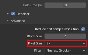

The root of the problem is the initial RTPATH setting for resolution: it is clear from the video that Cycles start rendering with blocks large as about 32x32 while Lux uses 4x4 (1 samples every 32x32 pixels Vs 1 samples every 4x4 pixels). Indeed, 4x4 isn't viable for full screen view port renderings.
I think we should also reduce resolution for first sample automatically and come back to native resolution(setting in green) after. In my test i get better fluidity with theses settings :

EVEN Block size at 2X and Pixel Size at 2X is impressive to work with. So for me the most affecting setting is Pixel size. If by any trick we can render at 1/2 of the native resolution and come back after first sample it will be great :

Sharlybg wrote: Sun Aug 30, 2020 3:34 pm If by any trick we can render at 1/2 of the native resolution and come back after first sample it will be great
This is exactly what the "reduce first sample resolution" option is doing if you set block size to 2 - unless I misunderstand what you mean.

You're right i don't know why but reducing the pixel size by two even without first sample reduction give me much more fluidity impression.

Thank you, that did the trick!
I'm experimenting with the block size and the pixel size values and is indeed much more responsive. Of course, at some point, I run into the light tracing limit. If I'm using caustics the result is quite messy. The preview gets stuck at the block construction part and it doesn't show the end result.
The pixel size tooltip indicates that it's about the native resolution of the monitor. That made me think what if I try on my second monitor?
My working monitor is UHD and the 2nd monitor is HD. It turns out, on the HD monitor I don't need to tamper with these settings at all, everything works just smoothly in fact, it runs faster.
