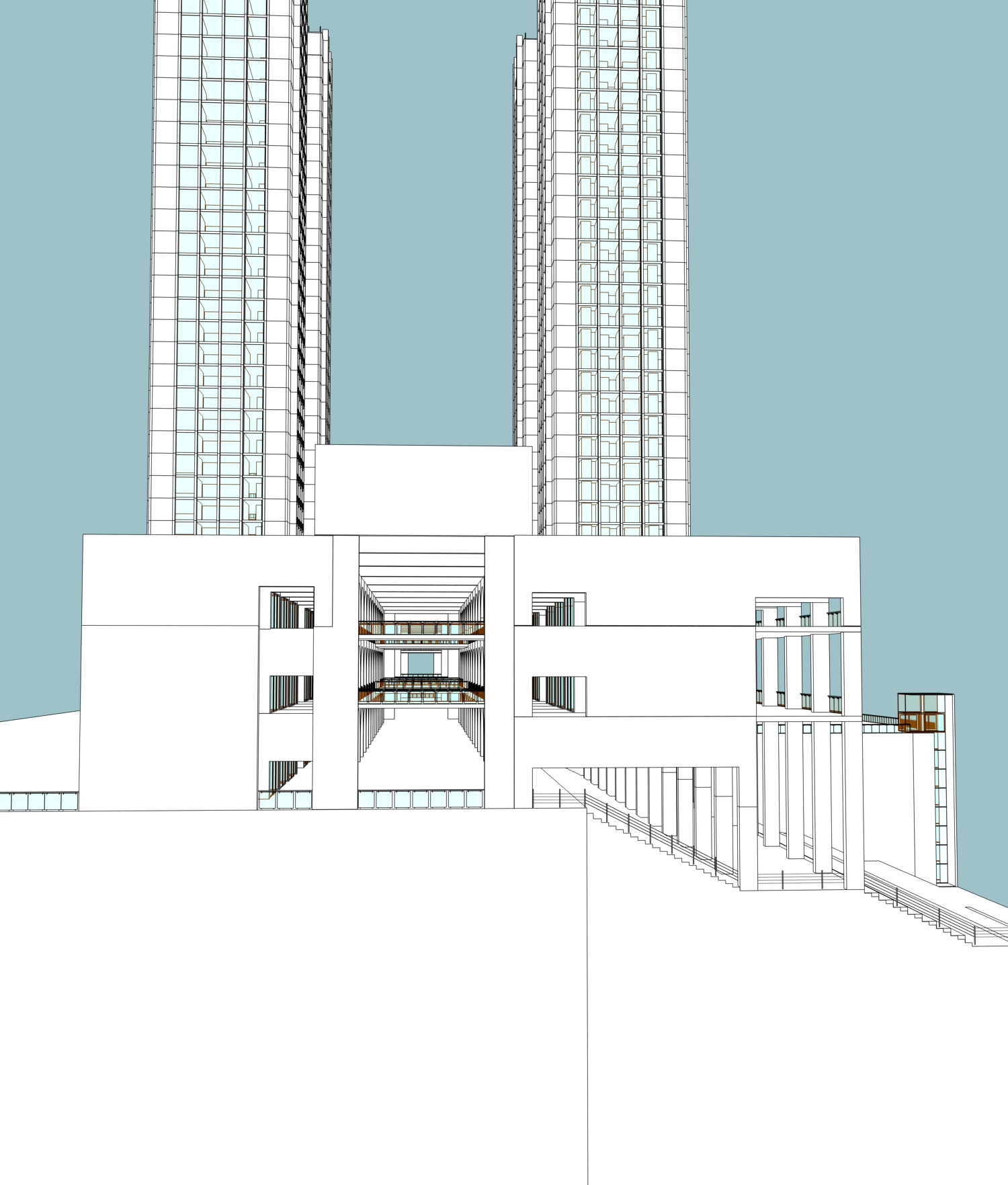

This is a super nice feature especially if there is a way to use it as an outliner. I'm looking forward to trying that.
I already make one with serious complex texture connections and looking forward to implementing an outliner shader.
This can be useful especially for architecture render or sketch design look.
Here is my result of what I was done with shaders and textures that I was able to achieve with 3dsmax LuxCore Plugin.
I'm not sure if it's going to be the same thing but I'm defenetlly looking forward to trying it.
