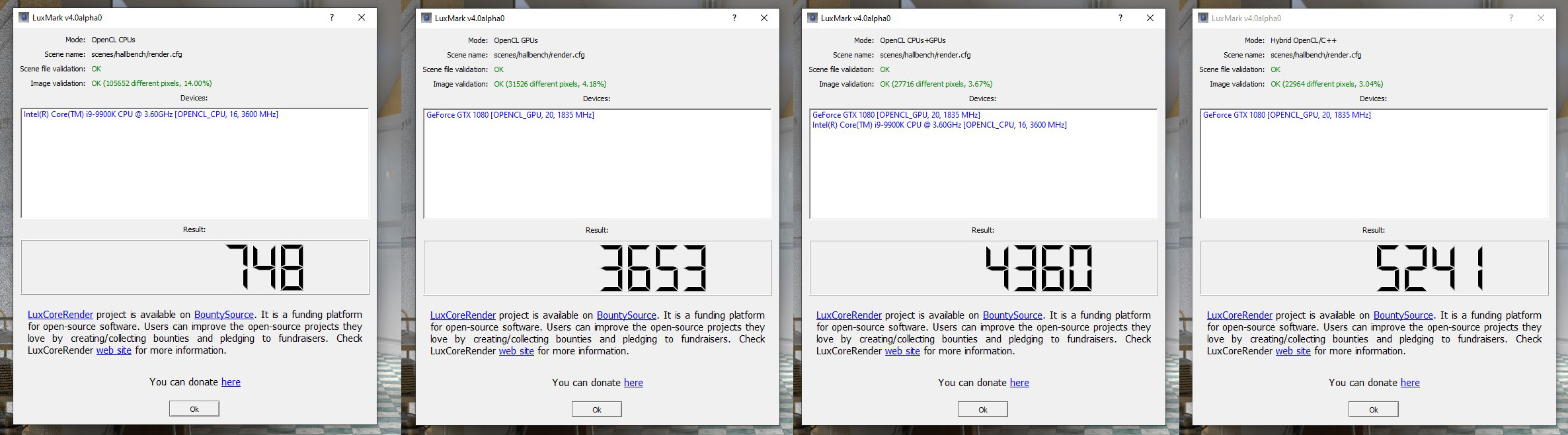

Does the GPU work as expected in Cycles and Luxmark?
Re: v2.3 Vs v2.4 performance
I think thats gonna answer your question.

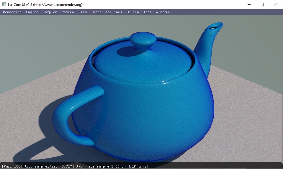

This looks just alright, now that it is based on LuxCore 2.2 makes it very strange that you cannot achieve similar GPU performance with the very same v2.2 LuxCoreUI and your simple scene

I find the same very strange behaviour with TAO's scene, i.e. GPU is very slow, with LuxCoreUI 2.2 (but 2.4 is ok).
This line in the config file seems to be the source of the problem, at least on my laptop:
If I comment it, then GPU speed is again very high.
