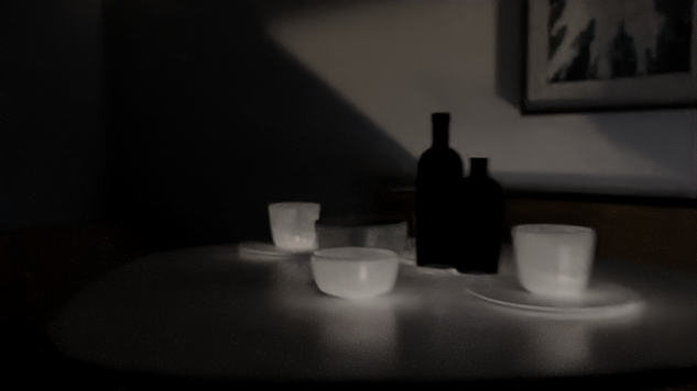

I'm able to reproduce the problem here, the frame 54 (and 58) is fine (caustics only rendering):
while there is a jump in brightness in frame 56:
I'm checking what is going on.
