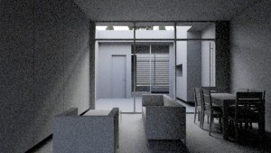

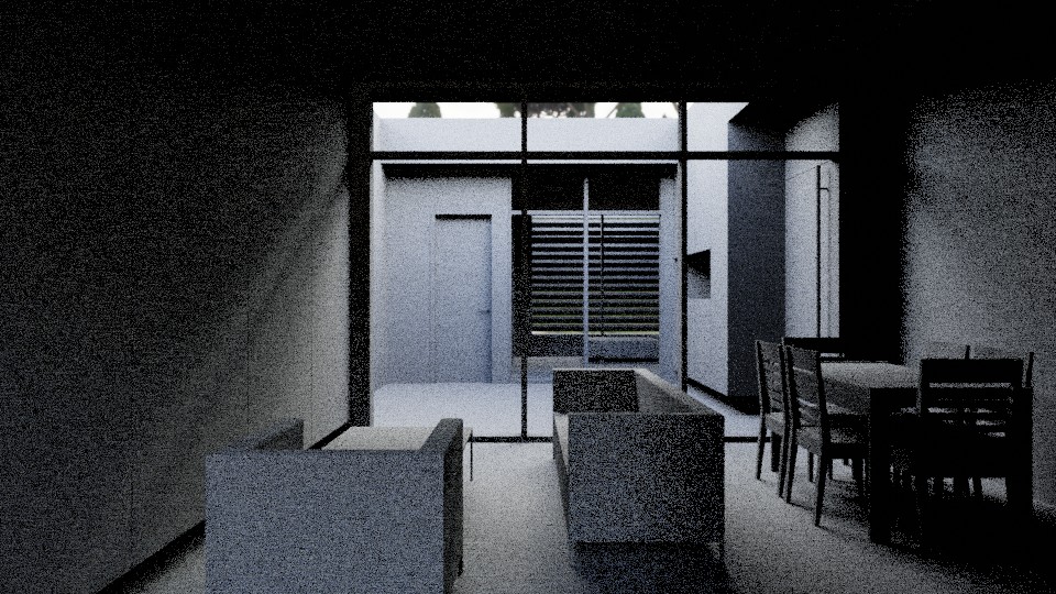

With further test i've the feeling that by using total path deph settings it is possible to bypass the n+1 behaviour.
Octane deph 1
Luxcore deph 1
Luxcore deph 2
Octane deph 2
As you can see Luxcore Deph 2 is different from deph 1. And only Octane deph look similar to luxcore deph 2 (same for deph 1 in both engine )
Octane deph 1
Luxcore deph 1
Luxcore deph 2
Octane deph 2

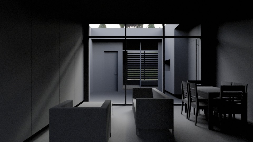

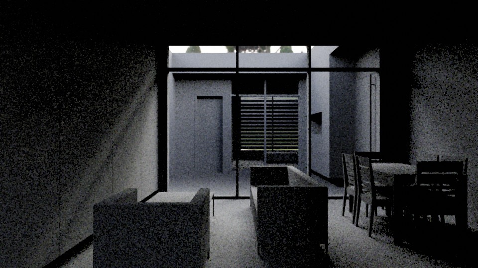

Not the same time. not also same quality. as you can see octane is clamping light very hard. at the same time you get this :are those same time renderings?
Octane 11sc Deph 1
Luxcore 11sc Deph 1

Interesting. Luxcore always introduces noise even in directly exposed areas, this is beyond me why it happens. How do we get noise even in the outside areas...Sharlybg wrote: Fri Jan 31, 2020 10:56 amNot the same time. not also same quality. as you can see octane is clamping light very hard. at the same time you get this :are those same time renderings?
Octane 11sc Deph 1
Luxcore 11sc Deph 1
I think if luxcore could clamp indirect light separately from direct ligh, we might be able to get closer result... maybe...

Yes, because it actually is depth 3 and 2. They are supposed to be different.
The relevant part of the code is here: https://github.com/LuxCoreRender/BlendL ... ig.py#L276
There's also a comment explaining the reasoning.

Sure i think the same. And also i remenber Fstorm behave a bit like that with strong Clamping.I think if luxcore could clamp indirect light separately from direct ligh, we might be able to get closer result... maybe...

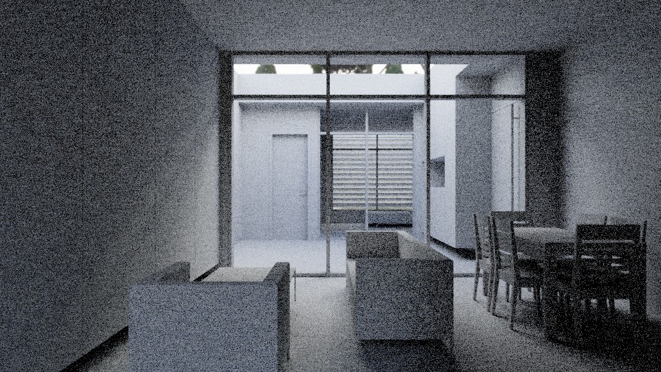

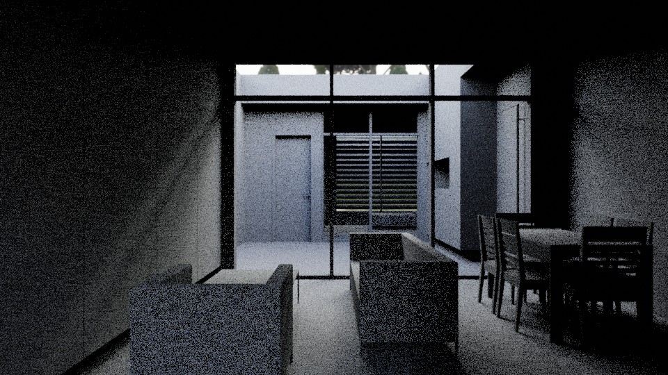

Ok so i've removed all the incremental value. Story is the same even if luxcore get now a bit darker Octane is even darker and clamped.Yes, because it actually is depth 3 and 2. They are supposed to be different.
Octane deph 1
Luxcore deph 1

it seems a huge difference...the main is obviously the noise.
Yes, also the lighting is different..but if you make a poll and ask "choose from noise and lighting what is the most different from lux and octane", I'm quite sure that 95% reply "noise".
I'm not sure it a just a matter of clamping...if you want to test this...why don't try to find the clamping value to have that kind of noise free on the surface that receive light?
In my opinion, in Lux it seems that we have always difficulties to clean not just the shadowed surfaces but the lighted too.
