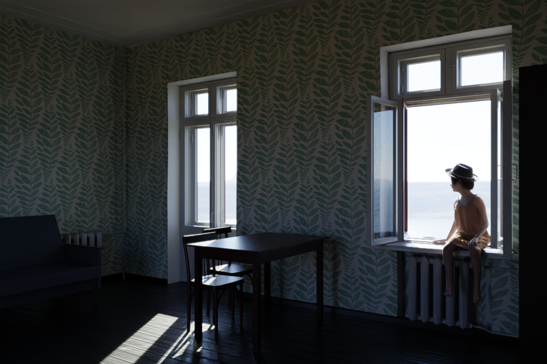

Thank you! I didn't do the bed thoughFarbigeWelt wrote: Sun Sep 22, 2019 5:21 pmNicely done. Especially the bed and the windows. Did you try tone mapper Reinhard? Maybe you can make the room brighter while keeping look through open windows as is.wasd wrote: Sun Sep 22, 2019 11:33 am I think this is the final version, there will be an animation.
I didn't try Reinhard, because I don't understand it.

Re: Room
I'm afraid it wouldn'tepilectrolytics wrote: Sun Oct 06, 2019 6:09 pmThe outside scenery is most interesting and seeing it animated would be awesome!
 It's not the scenery what's getting animated.
Hedge to the left has ~83000 tris per meter. That's about 100 times more than I want it to be and approximately 1.5 times less than needed to fill gaps.
Hedge to the left has ~83000 tris per meter. That's about 100 times more than I want it to be and approximately 1.5 times less than needed to fill gaps.Parallelepiped with texture seem to be the wrong way to do hedges.
Chain-link fence has 180k per 3x2.8 section.
The image is a little blurry, but I can't probably afford more than 150 secons per frame. That's Bidir+Metropolis. Also I can't render with GPU, because of clcreatebuffer error. It render 2 to 10 frames then stop. I'd rather render with CPU.
