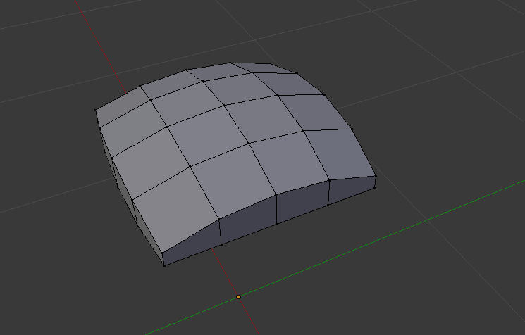

    I added a square lens. Have a look if thats what you wanted.
    It is perfectly square now, so not exactly like a u,v-sphere cutout, which would deviate a lot for strongly curved surfaces.
    However, the square surfaces at the moment are not perfectly defined, because I used quadrilaterals, and in this case not all vertices lie in the same plane. I will see what is the most elegant way to define surfaces elements... Shouldn't be much of a problem for most use cases though.
    On a side note, I also fixed a problem with the mirrors for focal lengths < 1.
