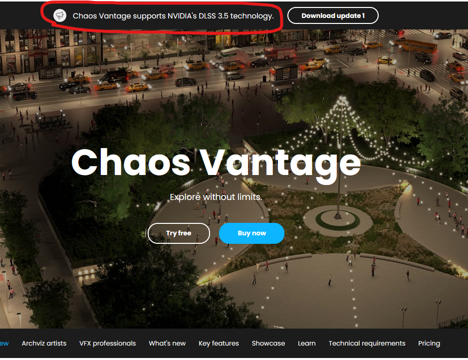

Chaos group adds DLSS 3.5 supersampling to vantage and it will be added to all of its products. Also, Amd add FSR supersampling to proRenderer.
