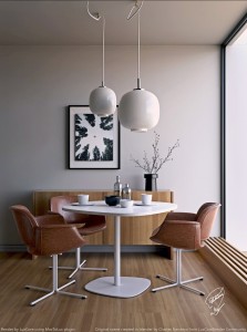

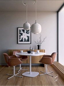

Lately, I found enough time and having fun to add AMD FidelityFX Super Resolution to the 3dsmax LuxCoreRender plugin, and with FSR, I was able to render in 1080p and make it 2k without any effort and adding additional time to render. it is a really handy feature when you want to do a fast small render and have it in a larger format.
Here is a simple test of it.
Orginal image in 2:46" 1069x1440px
2k image in 2:47" 2138x2880px
I tried it in 100 frame animation and it works the same.
I know it is mostly used in games but it can be used in any case like speedup or upscale or sharpening of interactive viewport renders to speed up viewport render.
It is a good feature that can be added simply to the core or plugins and anyone with no urge to render in native resolution can benefit from it or it can be used to speed up real-time interactive viewport render. (just an idea, may not work as well)

I tried to upsample the original image in Photoshop and added some unsharp mask and the differences with the Fidelity Super Resolution are minimal.
Re: FSR AKA FidelityFX Super Resolution
daros wrote: Thu Nov 25, 2021 10:30 pm I tried to upsample the original image in Photoshop and added some unsharp mask and the differences with the Fidelity Super Resolution are minimal.
It is different especially if you use correct settings, as it is works base on AI and not just the usual upscale algorithm.
By the way, scaling with 1.3x is almost the same as a render with native resolution, and super hard to tell the difference, as the scale factor goes up the quality will drop and you can see the difference but still much better than normal scaling.
as I check with 1.3x to 1.5x the render time will drop between 35% to 45% with a minimal quality loss and for someone how does not have the urge to render in the exact native resolution that could be a great advantage.

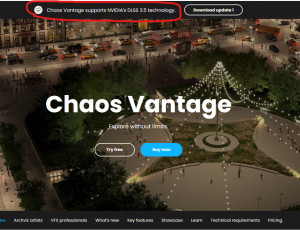

Chaos group adds DLSS 3.5 supersampling to vantage and it will be added to all of its products. Also, Amd add FSR supersampling to proRenderer.
It's sad that I gave up on that idea so soon.

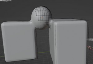

I hope i can find a time and release the build that I already prepared. by the way, if you are interested in my other plugins and add-ons you can check my GitHub. for example the PolyHaven assets manager for Maya https://github.com/OmidGhotbi/polyhavenassets or My SDF modeling addon for Blender
The volume shaders and all of its aspects need a huge overhaul to be faster.

TAO wrote: Sun Nov 26, 2023 9:22 pm I hope i can find a time and release the build that I already prepared. by the way, if you are interested in my other plugins and add-ons you can check my GitHub. for example the PolyHaven assets manager for Maya https://github.com/OmidGhotbi/polyhavenassets or My SDF modeling addon for Blender
Nice. Thanks for the info.
Yes, I'd really like to test your "SDF modeling addon for Blender", but can't find it?
Re: FSR AKA FidelityFX and DLSS Super Resolution
I will publish a new version very soon, it's much better faster, and with far fewer crashes, adding a layer to manage SDFs order, undo option, convert to mesh, and more, the open beta channel will be available soon.
