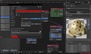

Blendluxcore lastest and blender 3.4 have tis issue Plus instant crash when opening the material render preview in properties panel.marcatore wrote: Fri Dec 16, 2022 8:26 am I've installed the latest nightly build, seems working (I've done a quick test) but the multi materials setup isn't working.
BlendLuxCore uses just the first material.
It lead to something like this :
