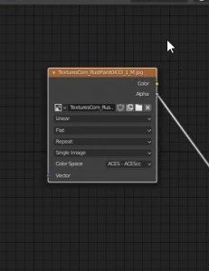

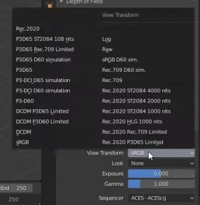

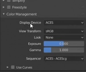

So I need to add Ocio/Aces manually in the blender and then I will be able to use it in luxcore by reading the data or Is just a single config.ocio file is enough because I already have all the Aces and OpenIO libraries available on my machine.
Because last night I start to add Ocio in the blender and I am still a little bit fuzzy here because I'm not a blender user. sorry if my questions are dumb.
By adding Aces to the blender all these options will be added to the blender and I can read them simply and purse them to luxcore. but I'm not sure if that's the correct way to and if I should add Aces/Ocio config to blender like this.

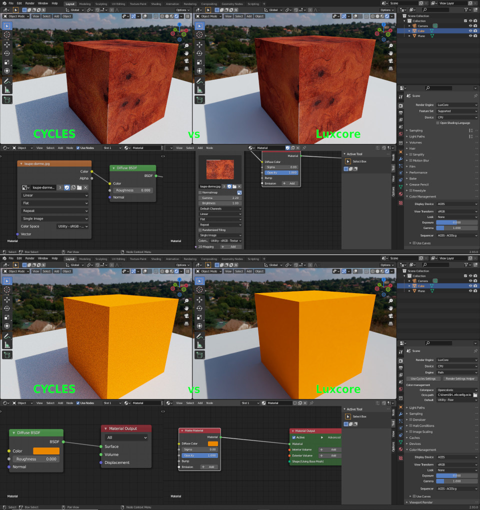

Thanks a kind Blender addon Developer on Twiter I have been able to Test
A first implementation of luxcore Aces with Blendluxcore 2.6 and blender 2.93 as test bench.
And here are the result. It much quite well Blender cycles behaviour :

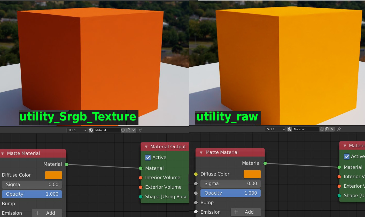

Diffuse color input space seem to be right with ""Utility Raw"" instead of ""Utility Srgb Texture""
with ""Utility Srgb Texture"" this how color shift :

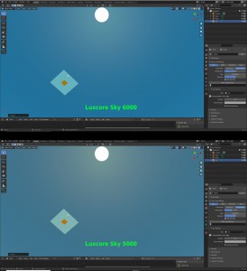

The Sky color also look to be mangeable with the temperature option :
