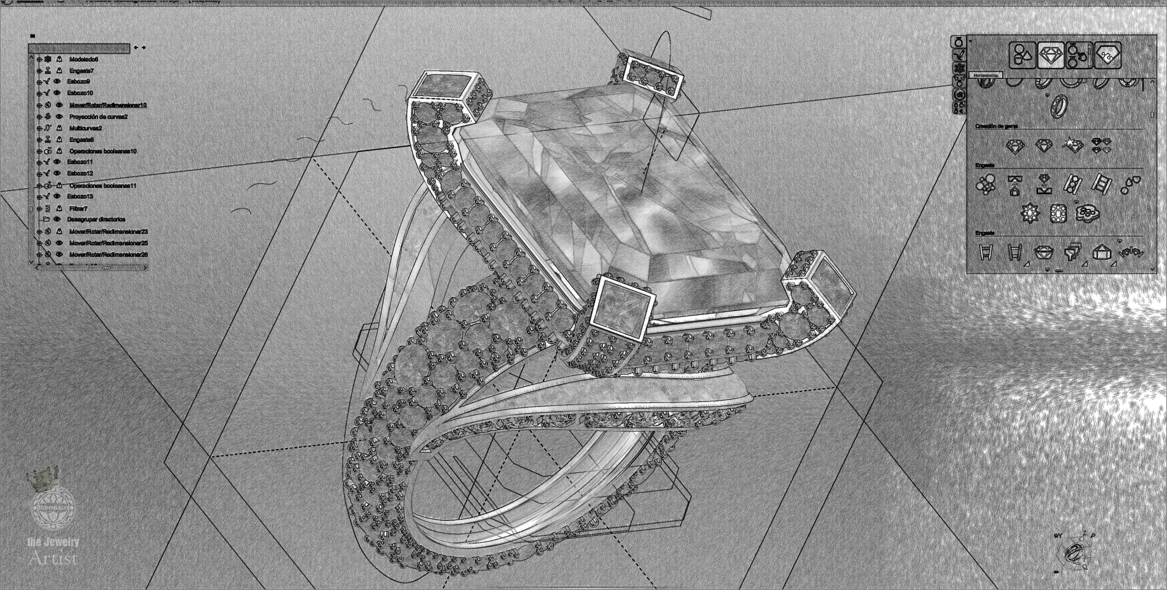

This ring was designed during advanced teaching for a client. The design is based on a photo of a real life design from their catalog, and they needed it to be recreated in 3D.
Final render, Luxcore latest build, 5K render, 1000 samples, light tracing,104 minutes render time
The render has very few touch-ups.
The model was created during a 4 hours class in 3Design, a CAD software for profesional jewelry design. The client did not request a render to be made, but the design deserved at least a try. So I obviously went and downloaded the most recent LUXCORE build. I was most pleased to see that it work wonders in Blender 2.93

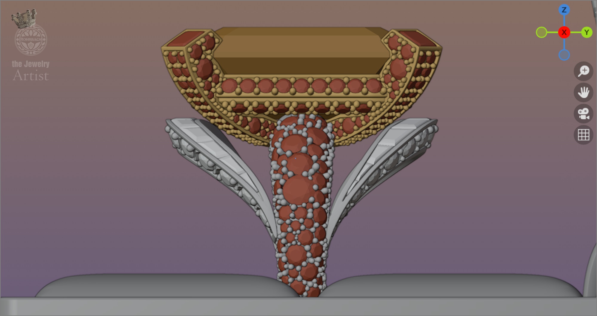

The ring seems to have a chaotic shape, but I am posting the side view to show that on the contrary, this ring as a very solid structure, and even looks like a flower, a tulip by example. When trying to photograph rings, something you will notice very quickly, is that many rings despite having amazing designs, look really bad from almost any angle, looking deformed (to the point that it is very often impossible to get a good angle of the jewel just by itself!)
