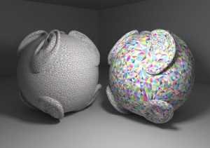

No ... but yes: displacement is applied only to surfaces but volumes are defined as the space inside a surface so the end result is the same.TAO wrote: Sat Jul 03, 2021 9:21 pm Thank you for the explanation, I will try to bake the scene in VDB format, just one question, can I apply displacement on the LuxCore volume shader?
This is the volume of a sphere with applied displacement:
The original surface with displacement:
Re: Volumetric render ....
