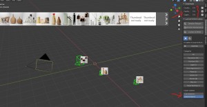

Great, just one question.
Am i doing something wrong, because it will be stuck on 0% all the time?
If i try many times finally it will download a few objects but even with the download manager, it takes time to start the download.
