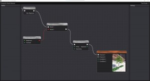

The very first node base compositor for 3dsmax is under development, first, it will be used for LuxCore to add options like light groups and other effects and after that works as it should, I will try to make it a complete opensource compositor for 3dsmax to be used independently.
Here is the first look. It is not finished yet and not all of the nodes integrated into it at the moment, also I still struggling with the idea and how should I create all nodes and mix them all but the idea and the basics are working now.
if this is working, it will be a great idea to add it to luxcore stand-alone version too.
i need to mention UI is base on imgui and nodeeditor.

As very often that look promising.
Great job.
Great job.
Why is Node 2 a different data type than Node 1 on the Mix node?
I still did not identify it correctly, I need to fix many things there and that is one of them. lots of work and a small amount of time, the old good problem as always.B.Y.O.B. wrote: Wed Jun 09, 2021 9:29 pm Why is Node 2 a different data type than Node 1 on the Mix node?
I have an idea to add conditions and other sorts of things too, like noises, grain, and more.
I get a few feedback from the Node base compositor and they all agree it is too much like Unreal blueprint and maybe I need to change it to something more like other compositors.
I did not decide that yet but I'm thinking of trying another interface design to see what will happen and what feedback I will get first.
