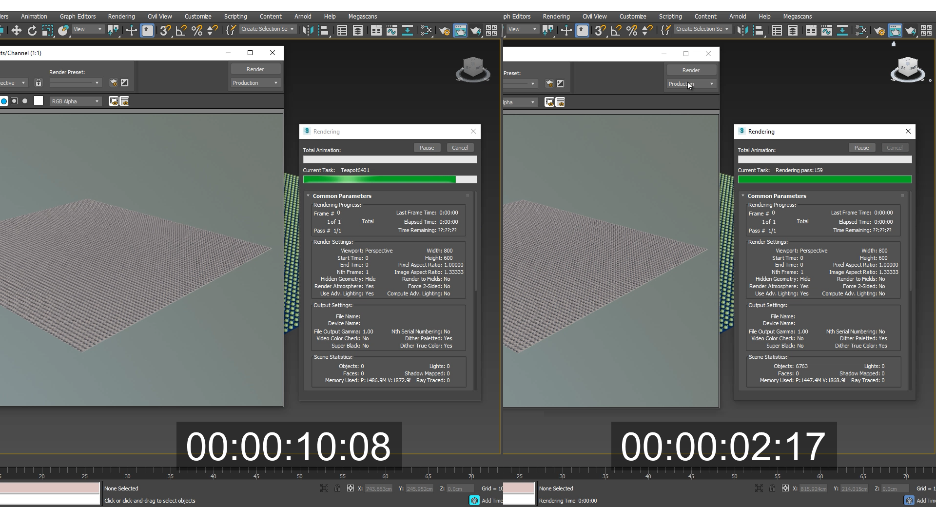

Post by TAO » Sun Jun 13, 2021 2:22 pm
Almost 500% faster in instancing with the new approach.
https://youtu.be/zvdrp2fWISM
Of course, it can be faster, even more, the most expensive part is accessing 3dsmax UI and updating it that can be done in a longer period of time and not for every single object and the other part is creating mesh by LuxCore itself that maybe I will be able to improve it later.
I test a simple update by just removing the 3dsmax UI and it gets around 50% faster, so in the next feature, I will plan to create a call back for updating UI that updates the UI in a longer period of time like just onetime in a second, doing such things in MFC is kind of a headache.
