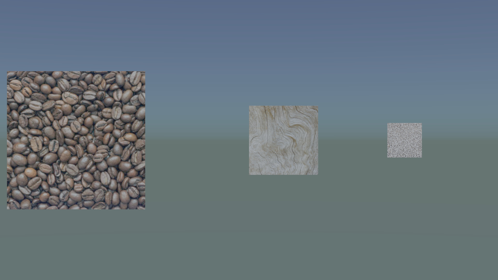

Policy: NONE
The "NONE" policy is the default and it doesn't resize the images at all. It is defined by:
scene.images.resizepolicy.type = NONE
This is a test scene with "NONE" policy:
Texture image maps memory used:
[LuxRays][0.524] [Device GeForce RTX 2070 SUPER CUDAIntersect] ImageMaps buffer size: 5376Kbytes
Se other policies for some comparison.

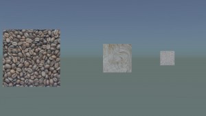

Policy: FIXED
The "FIXED" policy allow to apply a fixed scale to all image maps. For instance, to scale down all image maps by a 50%:
scene.images.resizepolicy.type = FIXED
# The scale to apply to all image maps size
scene.images.resizepolicy.scale = 0.5
# The minimum size of an image map
scene.images.resizepolicy.minsize = 128
While quite drastic, this policy can be already useful to reduce the GPU memory usage in case you run out of space.
This is a test scene with "FIXED" policy and a scale of 0.5:
[LuxRays][0.737] [Device GeForce RTX 2070 SUPER CUDAIntersect] ImageMaps buffer size: 3648Kbytes
