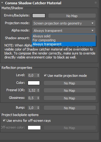

I will post here images of the corona shadow catcher with transparent glass with refraction.
Corona Beauty pass Corona shadow catcher transparent mode Corona alpha Within the settings of the corona shadow catcher material, we can choose between solid (such as luxcore, without glass transparency), composition (with shadows) and the always transparent mode (with transparent glass and alpha channel).
