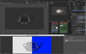

Don't really know the inner workings or how much work it would take or even if its possible considering the differences between the way Cycles and Lux calculate light, but in Cycles its kind of easy to get an Alpha trough Glass materials.Considering Lux is much more suited for the kind of renders in glass and liquids it seems it lacks on this area.At least to my knowledge and apart using Architectural option there's no way to get that Alpha, which really doesn't look that great.
I know I can get the Alpha from Cycles and use it on Lux render but was wondering if there's at least a possibility that this "feature" could make it eventually to some future LuxCore version?

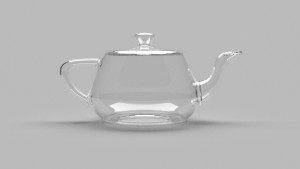

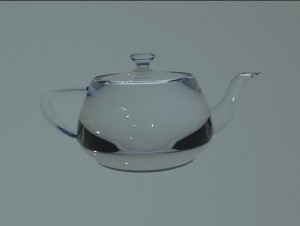

Just a simple Glass Teapot, Lux Glass default:

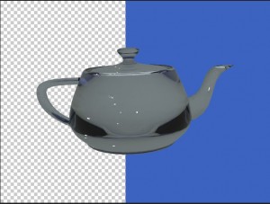

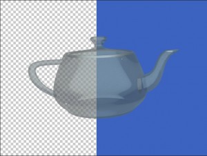

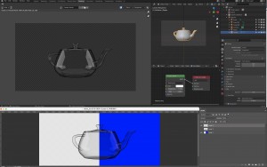

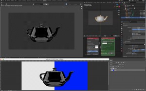

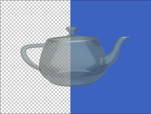

You have just to use Glass + material transparency (probably called opacity in Blender) and you get a Cycles-like alpha channel.
						Re: Would it be possible to get Alpha on Glass Materials?
I give it a try and that's the result.
Glass with 0.5 transparency Glass with 1.0 transparency Orginal render frame buffer with 1.0 transparency

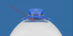

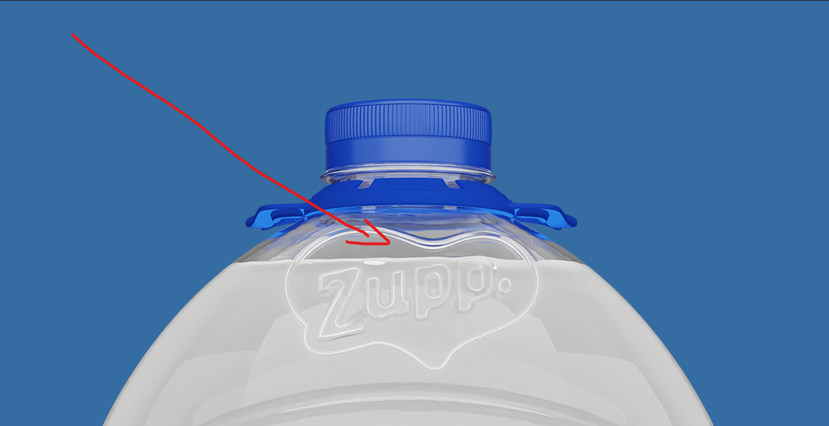

This does not solve Dade, for example a bottle has to be transparent where I have no liquid. I cannot change the transparency of the whole bottle.
Luxcore glass turns white without transparency

I don't even think Cycles is ok, its closer but not ok.The light reflections really shouldnt keep that much Alpha, those are reflections on a glossy surface that should cancel the transparency. Think Lux just could "do it better". Putting transparency on a glossy light reflection is a bit "weird".Dade wrote: Sun May 09, 2021 8:52 pm You have just to use Glass + material transparency (probably called opacity in Blender) and you get a Cycles-like alpha channel.

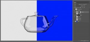

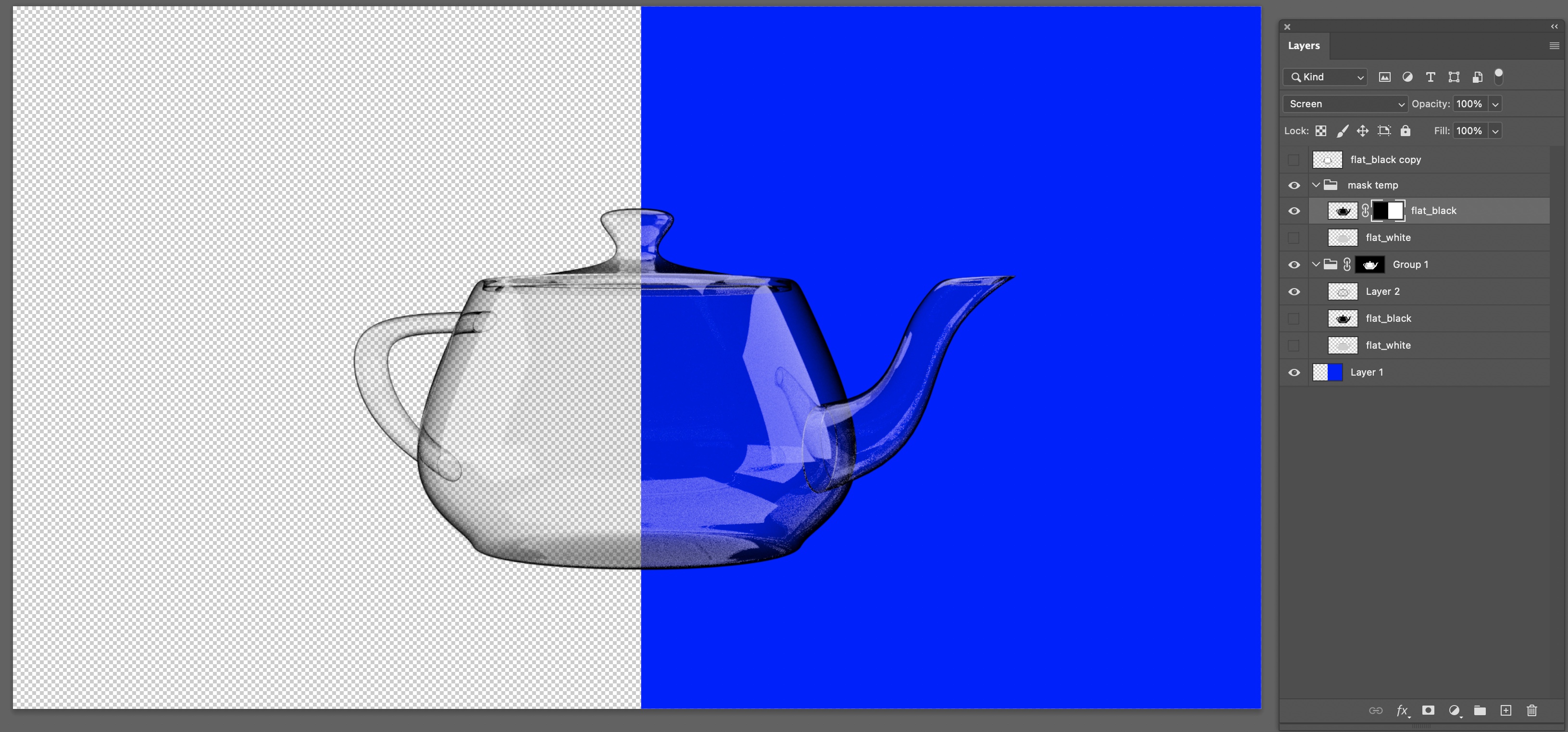

Not sure I understand your proposition,Im a post-producer/retoucher that took interest in 3D not long ago, I'm obviously not very skilled at 3D and certainly not a physicist, but being a unbiased rendering engine+physically based  just stating that giving transparency to a whole object material is probably not the way to go as light reflections shouldn't carry the same transparency change.At least as far as my logic goes.And I don't mean any disrespect by that, I honestly ignore the inner workings of that.
I can composite my way out of it, mixing black and white blackground+ diference in both and inverting the result for a mask and a bit of tweak for shadows reflectionns..whatever...this is actually kind of what I was expecting in the first place:
Just stating that its obviously possible to get better results, as Cycles does to some extend, but again: I dont know the differences between the two, maybe its not possible in Lux?

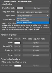

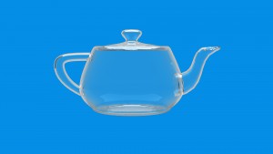

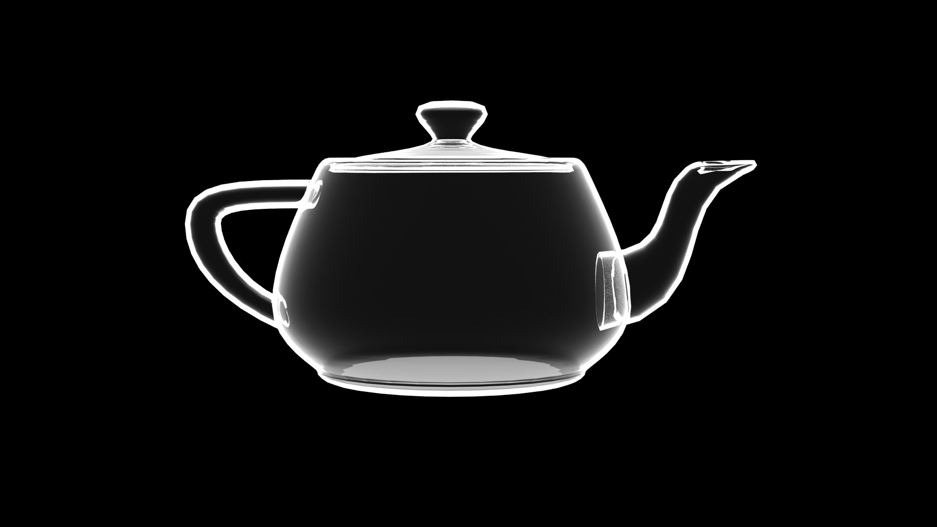

I will post here images of the corona shadow catcher with transparent glass with refraction.
Corona Beauty pass Corona shadow catcher transparent mode Corona alpha Within the settings of the corona shadow catcher material, we can choose between solid (such as luxcore, without glass transparency), composition (with shadows) and the always transparent mode (with transparent glass and alpha channel).
Hope this helps
