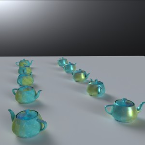

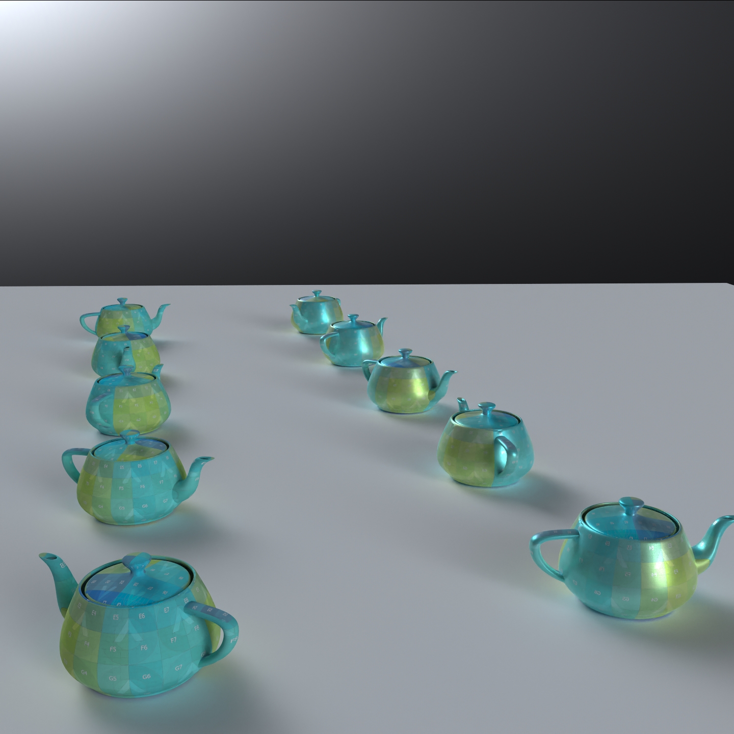

test mirror.zip
(325.26 KiB) Downloaded 669 times

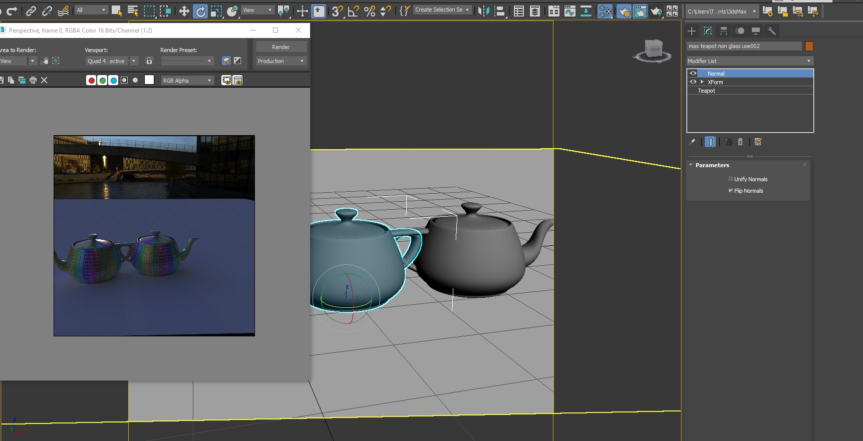

patro wrote: Fri Mar 26, 2021 1:33 pm test mirror.zip
I see what you mean, that's not an issue with luxCore or MaxToLux. This is a known issue with one of the oldest mirroring tools in 3dsmax, they need to update the code.
https://knowledge.autodesk.com/support/ ... s-Max.html
The only fix is to add an Xform and then a Normal modifier on top of that.

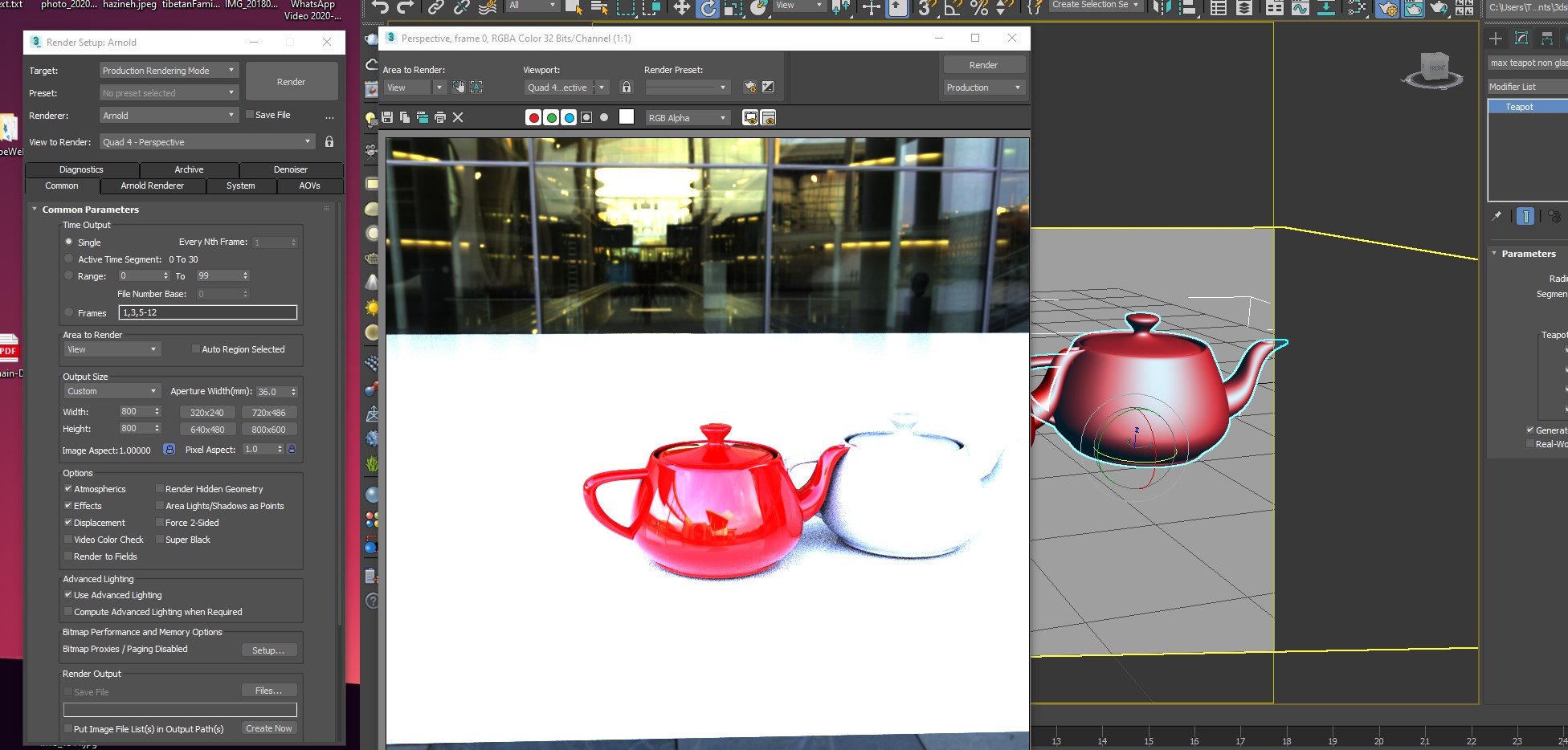

Fliping the normal is exactly the case. That's the same for others rendered like Arnold and even viewport in case of visible reflection. they already add it in the knowing issue in Autodesk knowledge.
The issue will affect only the reflection, as it said on the Autodesk page.

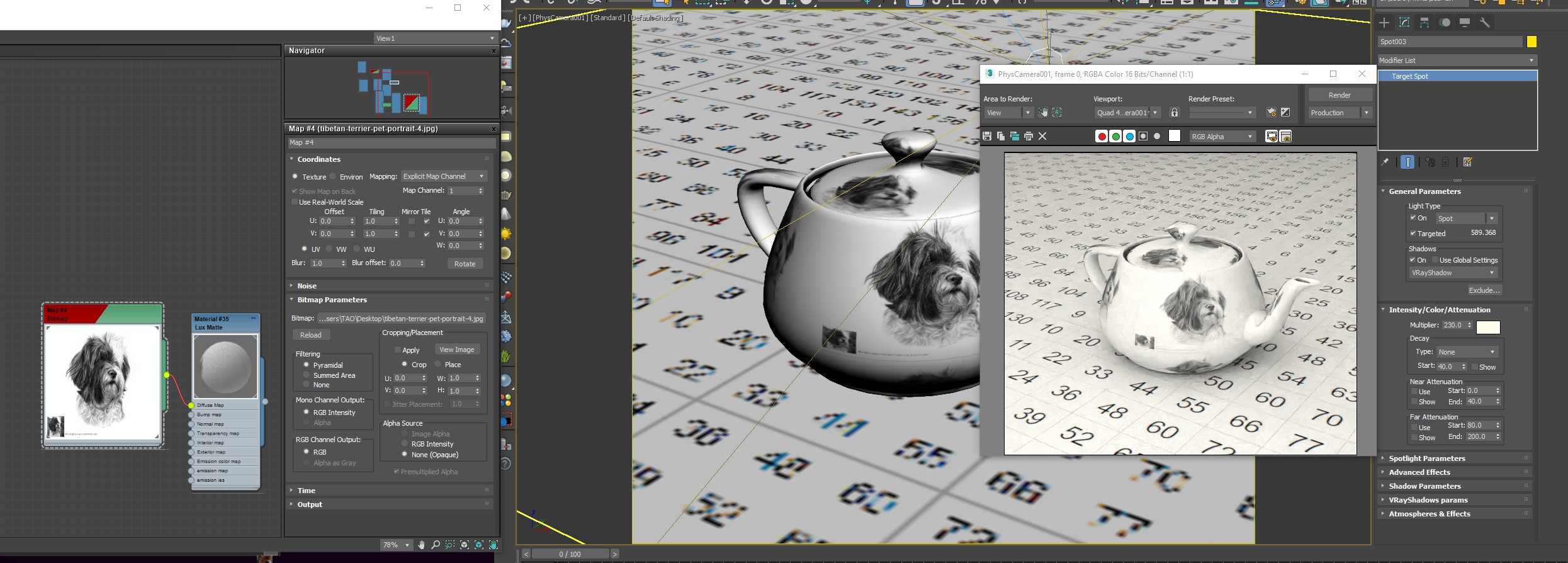

A reported issue with the used bitmap is rendered mirrored if the geometry has no UVW Map modifier applied has been fixed.
