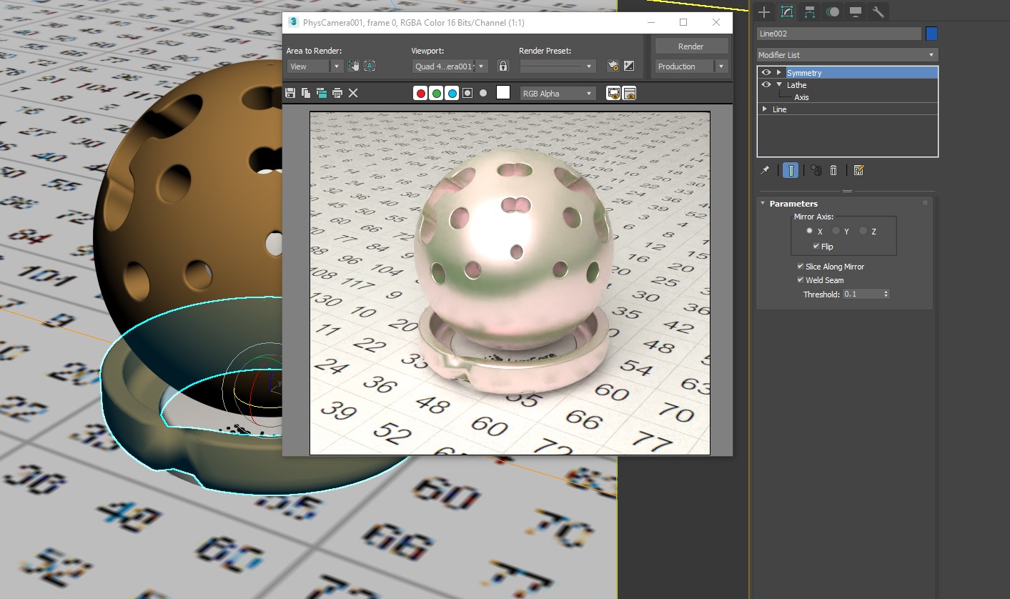

I tried symmetry with the new build and there is no issue but I'm not sure if that will fix the mirror problem completely.

you mean the problem that I showed you about the mirrored seams on the strap?TAO wrote: Fri Mar 26, 2021 8:46 am I tried symmetry with the new build and there is no issue but I'm not sure if that will fix the mirror problem completely.

That would be great because i fixed the issue but i need to be sure with other scenes it works too.patro wrote: Fri Mar 26, 2021 9:36 amyou mean the problem that I showed you about the mirrored seams on the strap?TAO wrote: Fri Mar 26, 2021 8:46 am I tried symmetry with the new build and there is no issue but I'm not sure if that will fix the mirror problem completely.
