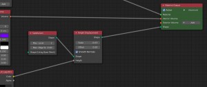

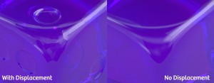

When using the Subdivision node in combination with the Height Displacement node - is there a way to keep the smooth shading of the surface?

AndreasResch wrote: Thu Mar 25, 2021 6:03 am When using the Subdivision node in combination with the Height Displacement node - is there a way to keep the smooth shading of the surface?
Some information about this issue as well?

Smooth shading is preserved :?:

Here's a comparison with and without displacement.
Here are the nodes.
