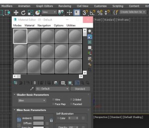

By the way, can you confirm, the material editor does not crash anymore or the problem still persist?
yes it keeps crashing max when I open the compact material editor, but it doesn't happen with all the scenes and I know the workaround.
Do you have a special material on the scene or for example an old version of null material?patro wrote: Sat Feb 20, 2021 10:42 pm yes it keeps crashing max when I open the compact material editor, but it doesn't happen with all the scenes and I know the workaround.
It should not crash at all.
Can you send me a scene so i see what i missed?
And remember, do not save scenes with filesaver enabled, i will fix that very soon.
I can pack the scene, it's the luxball scene. There is no null material.
The issue happens with compact material editor. You may try yourself first: open a scene, instead of slate open the compact mat editor, it might crash max.

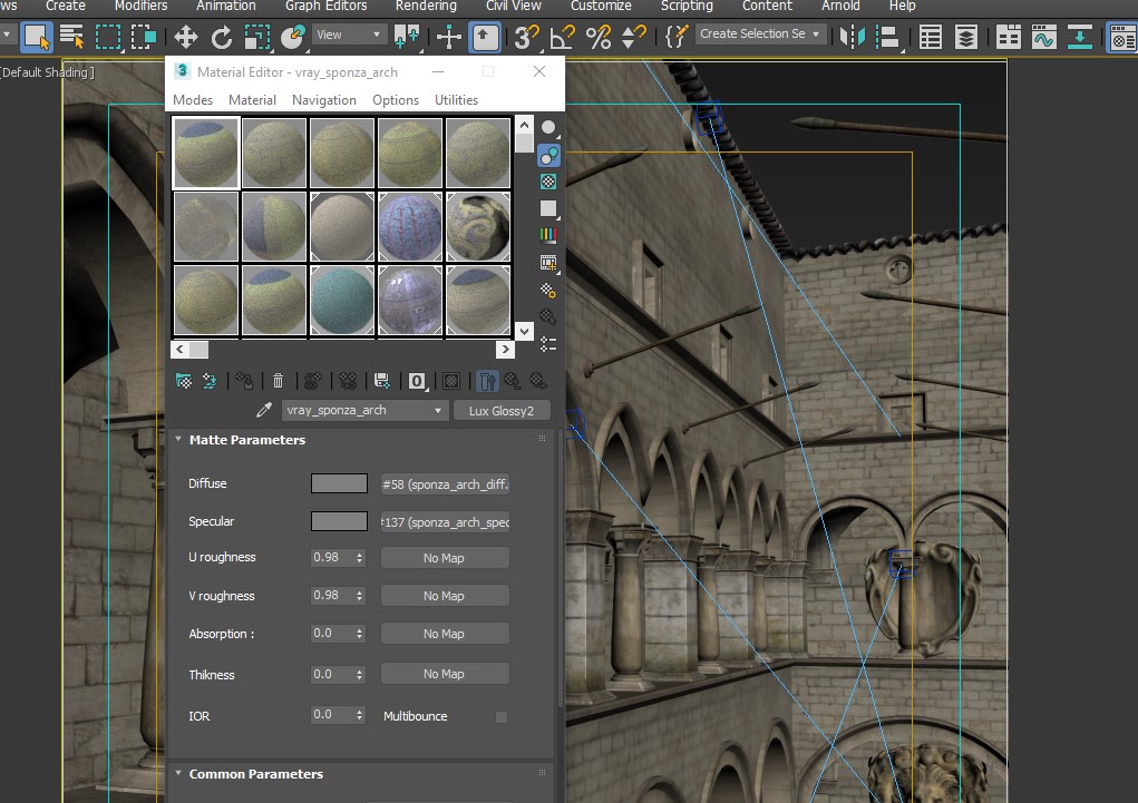

Btw, I ask you to send me the sponza scene, I still didn't receive. I need to understand how you did manage such soft bump. I've been not able to replicate it
Check your personal messages.patro wrote: Sat Feb 20, 2021 11:27 pm I can pack the scene, it's the luxball scene. There is no null material.
I cant see the problem, it's not crashing for me at all. a simple scene, complex scene, empty scene, I tried all but nothing happened.

@TAO I tested it
compact mat editors scene now opens without problems
btw, the sample slots seams to render faster also, meant are all slots including those which had all textures linked properly.
Wow, amazing fast. thank you for the effort.
