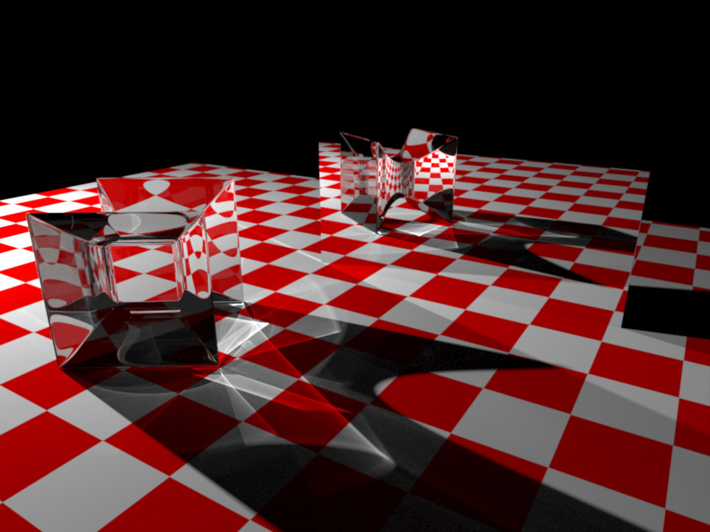

So what about BiDir + PGI cache, can it do reflected indirect caustics as well as BiDirVM?
Example scene:
Light tracing does not catch indirect caustics (DSD paths) and the caustic cache thus not DSDS paths.
BiDir can do those, but DSDS are slow; BiDirVM is way faster with these.
Example scene:
