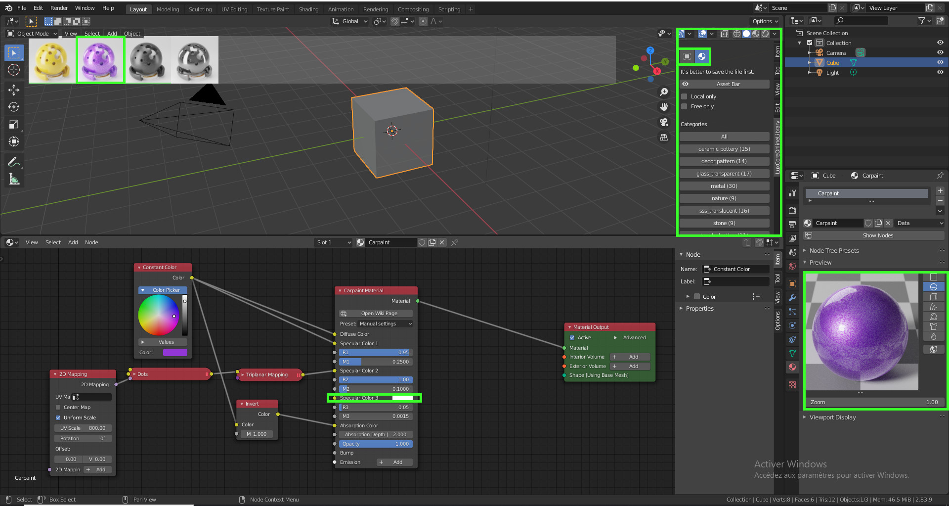

Sharlybg wrote: Thu Apr 16, 2020 6:47 pm Thanks for the reply. Yes this is what i get currently with dot. But my purpose is to use dot texture for flakes layer in a carpaint shader.
I know the cycles voronoi cells texture work great.
Recently, I've been working on the carpaint material of arnold, which has the flakes function, which is similar to the picture you sent. emm... I want to get your shader or blender file to learn how to implement similar functions in luxcore.
Re: BlendLuxCore Development
Maybe you don't know but you already have it :
just press N in viewport to enable N-Panel and from the panel go to luxcore online library (i assume that engine is set to Luxcore).
From the Luxcoreonlinelibrary select material icon down in category MISC(4) select the purple ball to assign it to anything you have in the 3D view.
As there is a small error (need update , in fact the specular 3 chanel shouldn't be connected to the constant color node) on the shader:
BLEND
Carpaint.blend
(1.88 MiB) Downloaded 1324 times
TAO wrote: Thu Jan 28, 2021 10:35 am Very nice feature, I did not know you implement an online material library.
I certainly need to check that and if it's possible investigate how can implement it into 3dsmax.
To be precise Neo2068 is the Library Dev. I just provide the assets ;)
The locked asset can be download here : https://blendermarket.com/creators/draviastudio
