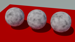

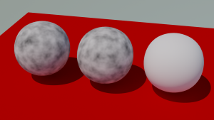

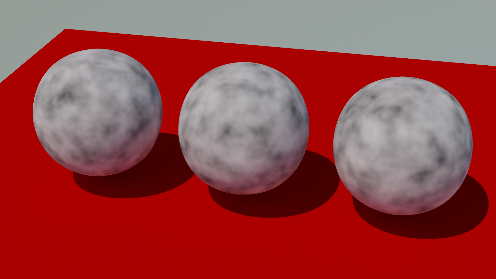

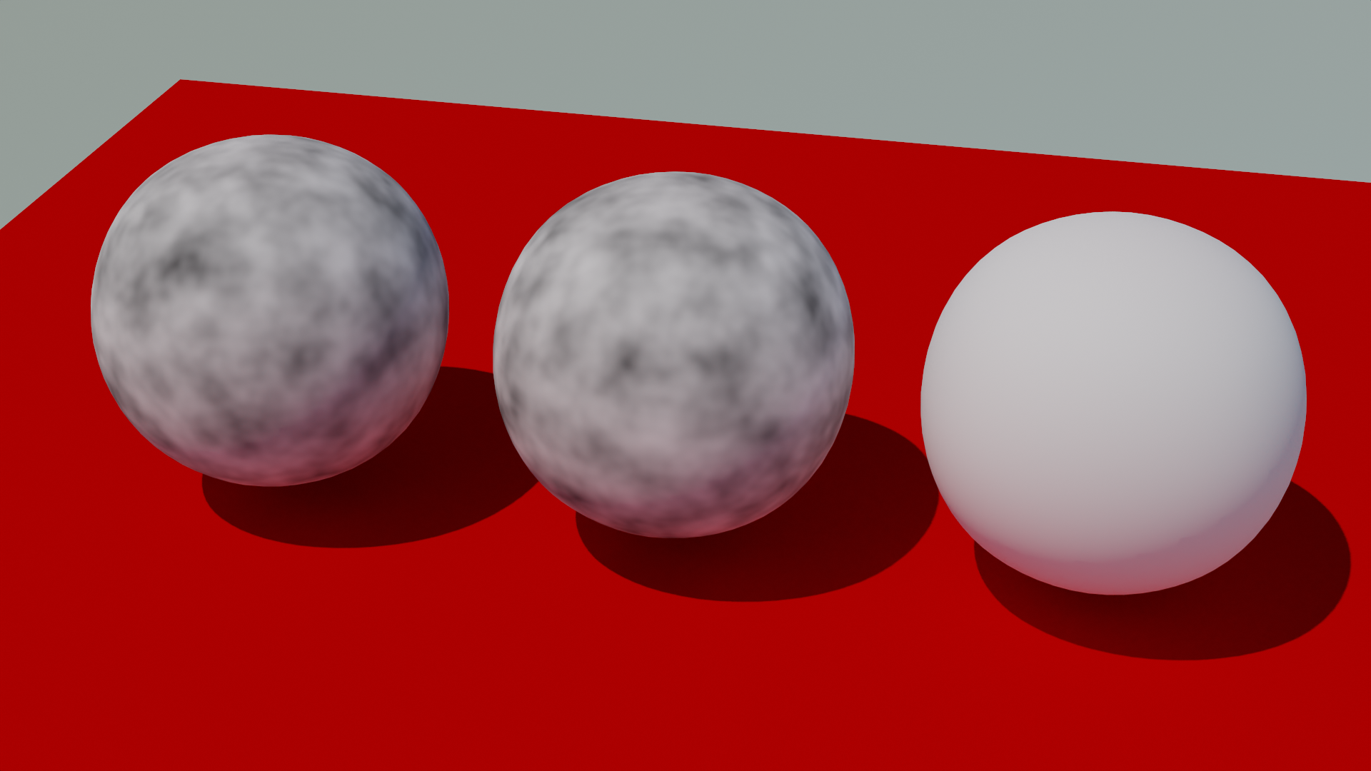

I think there might be a bug with this, when used together with a ColorRamp? :?
I first noticed this when I updated to the 2.6 daily (downloaded binary release from GitHub), on an existing scene with an image texture I was using for Roughness on a Glass material (I noticed it made the glass opaque), but I have been able to reproduce it just with Diffuse color too.
Before adding color spaces first commit:
Commit f932e1a01d3f0ca52512ab104b38801747b871b1
After adding color spaces first commit:
Commit 857c1cd2401ab9a31aa27ce5387e2dc0718577c9
The only difference between the three rounded cubes materials is what goes between the texture and the diffuse color socket.
  • On the left, the texture is directly connected to the Matte material Diffuse color
  • In the middle the texture is multiplied by white (i.e. no-op) first. I have also tested this with Remap and the result is still OK
  • On the right is a ColorRamp - broken :oops:

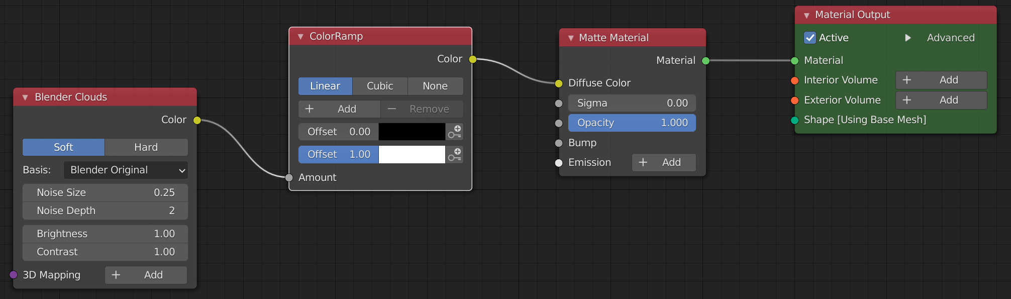

Below is the shader setup showing the issue
Shader setup that produces the issue

Re: Color spaces support (aka OpenColorIO v2.0)
I should have fixed the problem.
Post by Martini »
Yep, seems to be working perfectly again 8-)
Thank you so much! :D
