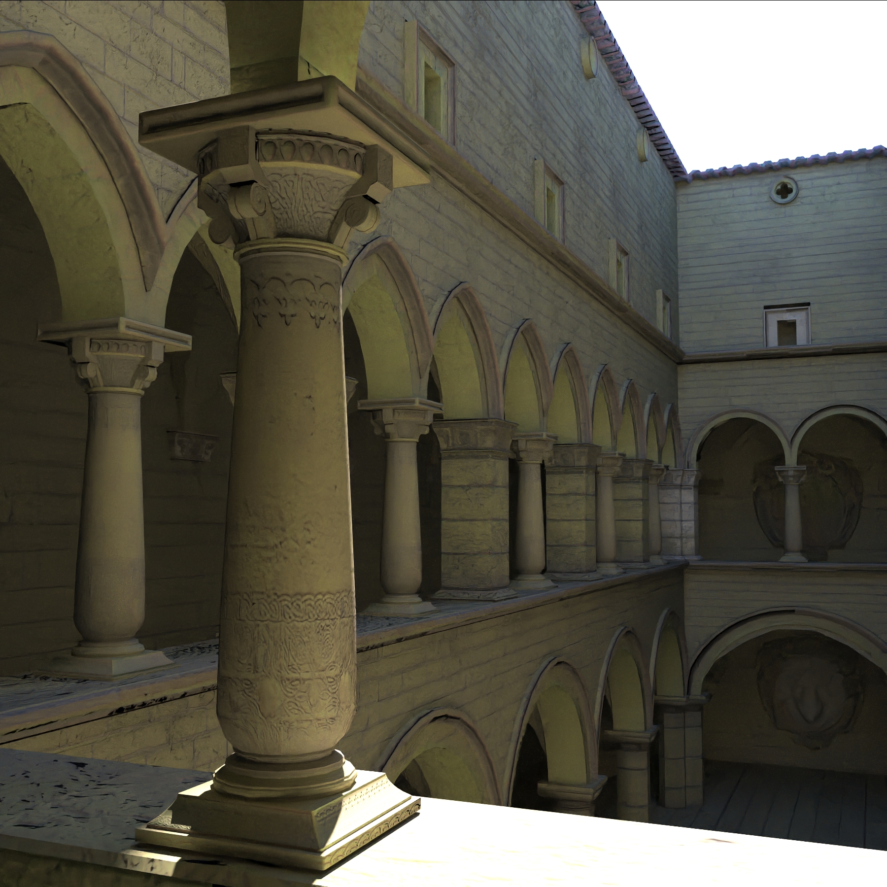

Hi TAO, I've finally been capable to fix the texture-wrong bump result i was having, now the sponza scene renders smoothly like yours.
Maybe it is a problem related to 3ds max 2021 only.
The fix is to add to all geometries the modidier Unwrap UVW, just adding it, without any editing, if I recall right, it's still not supported by maxtolux, but it does the job.
The image i rendered foir only 40 pass, but it is clear that the modifier do great in this case. Are you going to release soon a build with the instace support?
