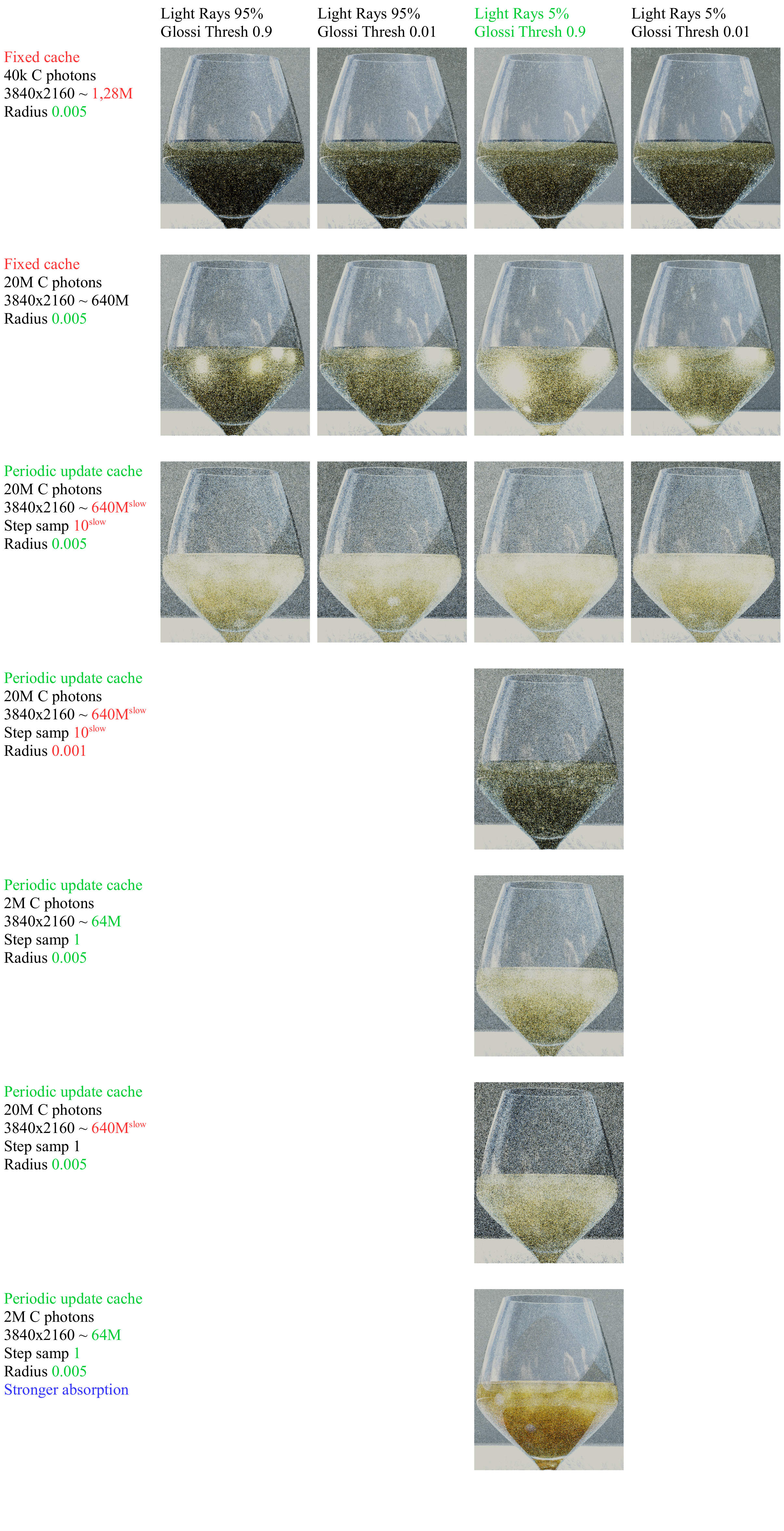

Was studying the caustic cache, thought i share the results.
Re: PhotonGI caustic cache re-factoring
Oh god, volumes inside glass are absolutely horrible in luxcore (maybe in other renderers too) there needs to be a "convincing" looking way of handling such situations.
Right we have a fix for glass (shadow color), but roughglass is dark(let's pray multiscatter ggx in future disney will fix this) and any liquid in glass will have a terrible time looking convincing.
there needs to be a cheap way for quick sss features like wax, skin, ice, juices in glass etc... Cause now we're setting up materials like a minute per object and you hit an sss problem with juice in glass and might as well try to buy rope to hang yourself on.
