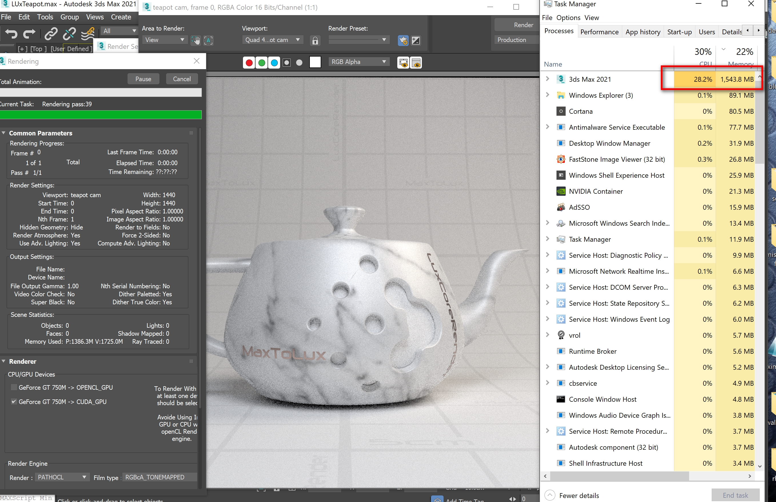

Post by patro » Fri Apr 16, 2021 3:17 pm
I rendered the same scene with maxtolux 8.2.7 and with 8.7.9 and it is showing a memory problem.
see attached screen shots.
first is made with maxtolux 8.2.7 ram usage is constantly floating to max usage of 1.543... shoiwing pass 39, but it can run for 600 passes more and by stable ram usage.
the other 2 screen are made with new 8.7.9 taken at pass 42 and at 64
as you see the Ram is increasing by the time.. it will reach 13GB /14GB by about 100 passes

Post by TAO » Fri Apr 16, 2021 4:51 pm
Already fixed, just install the new version.
